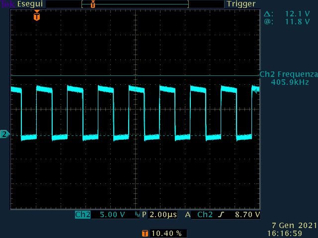

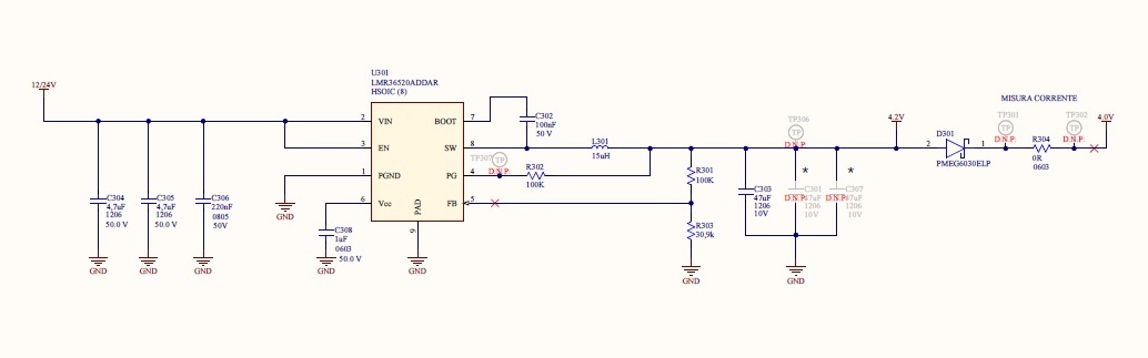

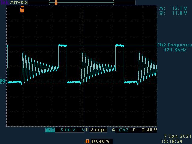

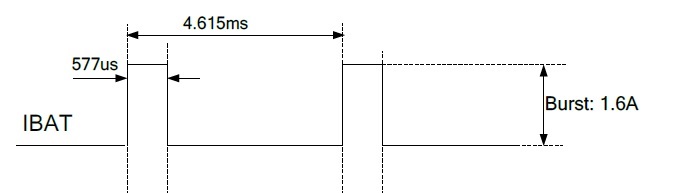

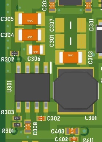

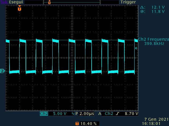

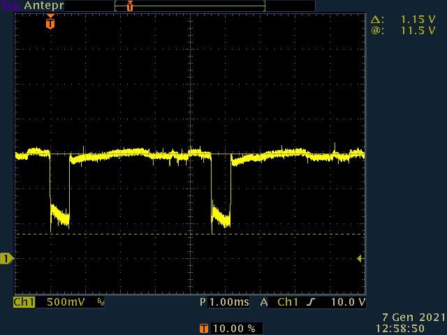

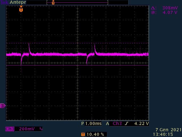

We've received a report from a customer that he is having noise issues with LMR36520A when he used it on GSM module project. The power supply specifications are as follow: Vin=12V and Vout=4V. When he tried to dial a number, the modem is working but there is an audible sound like flicker noise during the call. There are also current burst. He tried to change the inductor with higher saturation current but the noise is still present.
Here is the schematic diagram of LMR36520A for reference. I understand that he have to add EMI filter so I simulated the schematic diagram in Webench but the suggested EMI filter is for the input side of the LMR36520A only.
