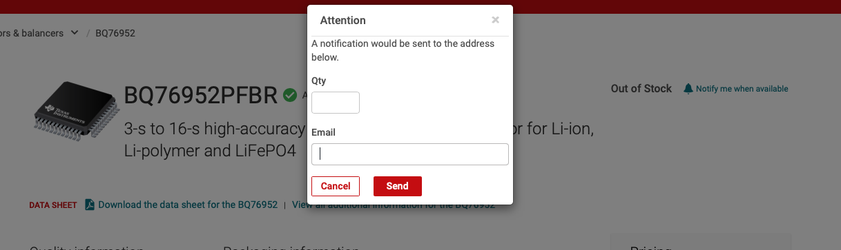

    Thank you for your interest in BQ76952. BQ76952 is in full production (ACTIVE) and we will have parts on the TI Store very shortly (in the next week or so).
    I suggest you set up an alert on store.ti.com as per the screen capture below.

    Please check the inventory on store.ti.com as I indicated: BQ76952PFBR parts are back in stock.
