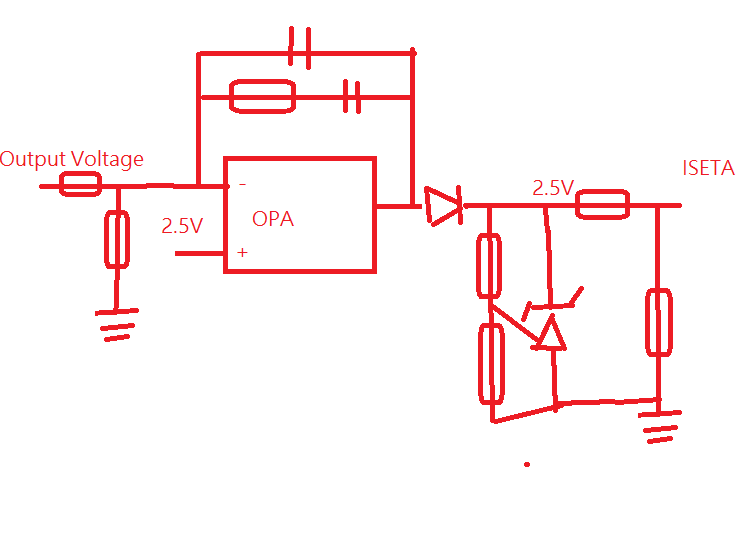

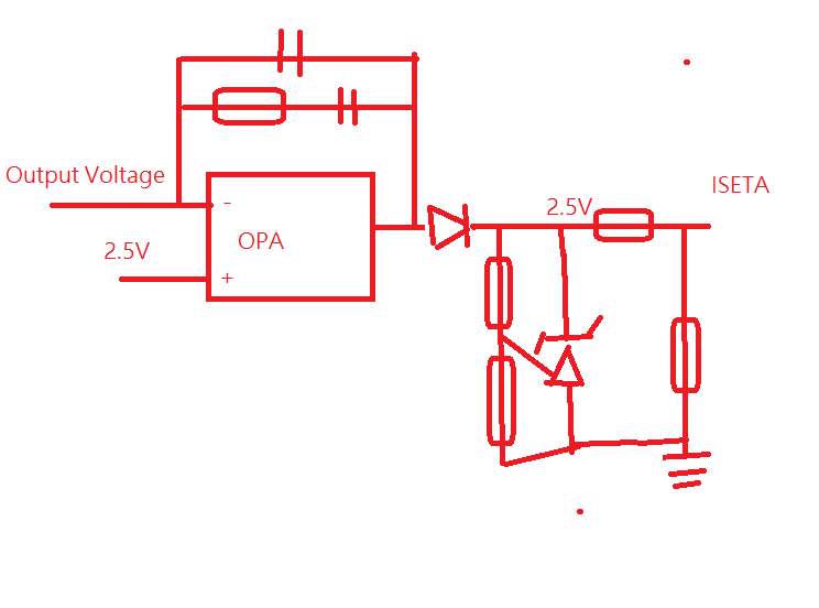

        But I have another issue, I can get the maximum current when used CC mode in electronic load, but the output voltage will be unstable when used the CV mode (setting below 10V),
        I think that no matter how much voltage is set in CV mode, it should be the maximum current drawn and output voltage stable, but the output voltage is overshoot leads to shut the PWM.....
        my spec as below.
       input: 30~60Vdc, output: 13.5V@22A
  • Hi Huangwei,
    if the e-load is set to CV mode, the device reach its maximum output current set by the ISETA and SETB
    what is the signal waveform at ISETA and ISETB at such condition? you can also try small value at ISET pins to avoid device shutdown
