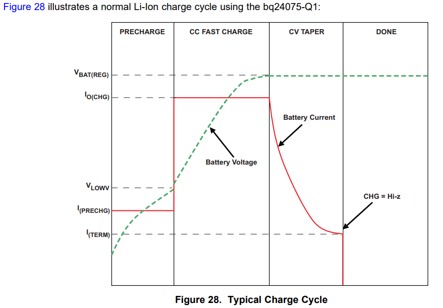

    As Gautham had mentioned, and he is true that there is some drop in the input cable and I changed input cable and voltage at input capacitor is now 5V,But still not getting 1.5A constant current consumption. I was aiming for charge cycle as red graph in fig.28 as mentioned in datasheet and  I also attached it here.
    How do I get that?

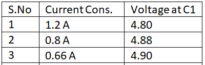

    A point to note here, Input is 5V in RPS and getting the same voltage to board measured at C1 without battery connected to board, But as soon as I connect the battery voltage is getting dropped and varying as attached below at C1(at IC input pin capacitor) and charging current is varying between 0.6 and 1A but I am expecting something as in Fig.28 in datasheet. Is this drop normal or do I need pay attention to this?

    Based on your data, it looks like the input voltage dropping may cause the output to drop and possibly the charge current to drop as well. With your configuration, this would be the reason why the charge current is reducing (DPPM).
    How do I get that?
    This is one charge cycle with a battery that requires pre-charging. This occurs over time with normal operation with the battery below 3V (the pre-charge to fast-charge transition threshold).
    This drop is not normal. This can be associated with the power supply not providing sufficient power or board connection issues.
