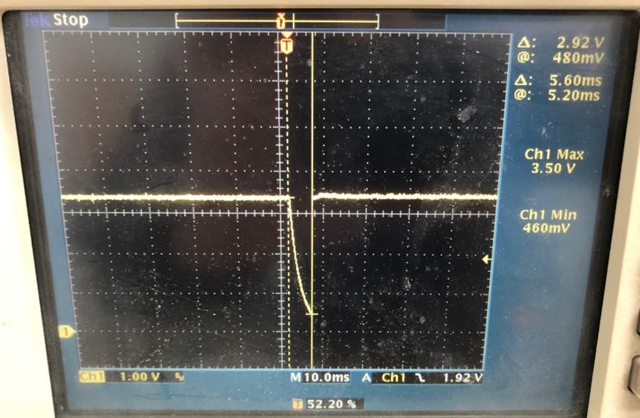

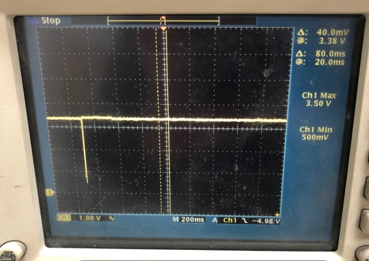

We are testing ESD contact +/- 8KV  on Pack+.
Wehn using +8KV on Pack+ we found out that REG1 has dropping 460mv. (We setup REG1 to 3.3V)
Please refer the figure as below.
Can you provide recommendations for us how to fix this issue?

    You might look at the REGIN voltage - if that has been disturbed by the ESD strike and dropped too low, that could cause REG1 to drop as well.  Where is the REGIN BJT collector connected in your system?  Is it connected to PACK+ or top-of-stack or between the high-side FETs?  If REGIN is experiencing a large transient, then the focus turns to how to protect it better from the strike.
    Did you monitor the POR bit?  I assume the device did not POR, since it would normally take longer than the ~5ms you show here for it to restart, but you might check that to be sure.
