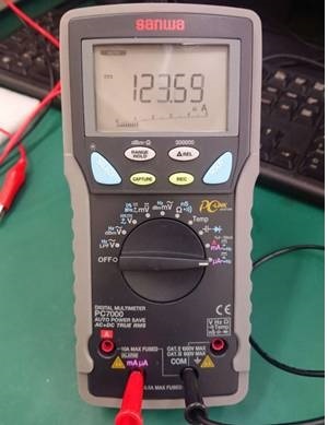

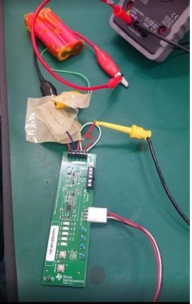

We are try to measure the quiescent current of BQ40z50 EVM when sleeping mode.
But the quiescent is always down to around 120uA. (CHG FET off)
Please refer the figure as below.

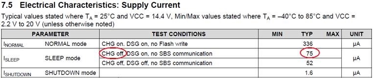

And we check the datasheet which shows the typical value is 75uA.

  • Hello Statham,
    Can you show how you are measuring the current consumption and a scope capture of the current consumption? Was the test with VCC = 14.4V?
    Is the value an average value of the current? Having larger max current is normal for the gauge.

    1. we use a electrical meters and series the B- point of EVM. I can post the photo but it's hard to understood how to connect by this photo.
    2. Even if we use 2s or 4s cell that current consumption is around 120uA.
    3. Yes is the average value, the peak current will be higher, it will over 200uA.
    4. Yes it help reduce current but which is still around 120uA.
