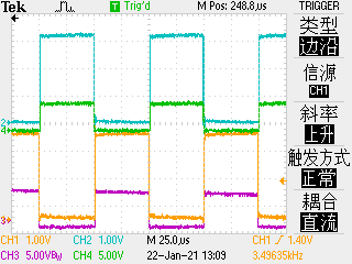

    1) The voltage range seen by the switch node (HS pin) is 0 to 12V. Figure 1 is a fault-free waveform at room temperature. The red "3" channel is the high side input waveform of LMG1205, with a 50% duty cycle. 10KHz frequency, the blue "2" channel is the high side output waveform of LMG1205, and the green "4" channel is the voltage of the switch node (HS pin); Figure 2 is the waveform when a fault occurs at a high temperature of 85℃. When it is low level, the high side output of LMG1205 is high level;
                                                                                                                                                                      figure 1
                  figure 2
    2) The high side input of LMG1205 is 10KHz and the waveform with a duty cycle of 50% is shown in the waveform of channel "3" in Figure 3. The high side output Vgs of LMG1205 is 4.5V constant high, as shown in channel "2" in Figure 3. The voltage from V_HB to V_HS is 5V as shown in the waveform of channel "4" in Figure 3;
              figure 3

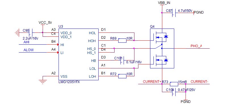

    3) As shown in Figure 3, it is composed of a half bridge. This schematic diagram has been verified. There was no failure in the previous 7 batches. After the measurement waveform analysis, the phenomenon shown is the high-end output of LMG1205 at high temperature. Will be out of control, so please help TI engineers to analyze;

    Thanks again for your patience and for the waveforms!  I have some more questions and variables I want to verify.
    1)  Can you please confirm that the V_cc voltage (on the board) is within the 4.5V to 5.5V range?  I was slightly concerned from looking at Figure 2 where the HO output is ~3V, which is over a diode drop below the 5V supplied (looking at the schematic).
    2)  May I also verify what the V_BB_in voltage is?
    3)  Based on the 10 kHz operating frequency you are using, I doubt that the driver losses are causing the junction temperature to increase above 125C; but to totally rule it out, may I please know what the gate charge of each FET is?
    4)  Regarding all of the capacitors used on the board, are they all X7R rated?  (To ensure that they are not too de-rated at high temperatures).  If they are not X7R rated, please replace them with X7R rated capacitors.
    5)  @ 85C:  When the HO output gets stuck high, does the LO output still behave as expected?
    6)  Regarding details on the behavior:  Does the failure occur as soon at 85C is achieved?  Or does it take a few minutes?
    7)  Regarding the 12 units that work again when brought back down to room temperature, do you know if they start working again before room temperature?  If so, please elaborate.
    8)  To confirm, 2 of the total 14 units that have the issue do not recover at room temperature?
    I look forward to hearing back!
    Aaron Grgurich
  • Hi Team,
    Thank you for your reply.
    1) The voltage of V_cc is normal 5V and has not changed;
    2) The voltage of V_BB_in is 12V. The V_BB_in in Figure 2 and Figure 3 that you see is not 12V is due to the short circuit of V_BB_in caused by the conduction of the upper and lower tubes of the FET;
    3) The gate charge of each FET is 6.8nC;
    4) X7R capacitors are used on our board;
    5) @85C: When the HO output is stuck in the high position, the LO output is expected;
    6) After the ambient temperature reaches 85°C, it will take a few minutes for the fault to recur;
    7) When we did the test, when the ambient temperature dropped to about 45℃, 12 units could work normally, and they could work normally even when they returned to room temperature, and they could also work normally at -40℃;
    8) 2 of the 14 units cannot work normally at room temperature, and the fault has been recurring;
    Looking forward to your prompt reply.
    Jack
