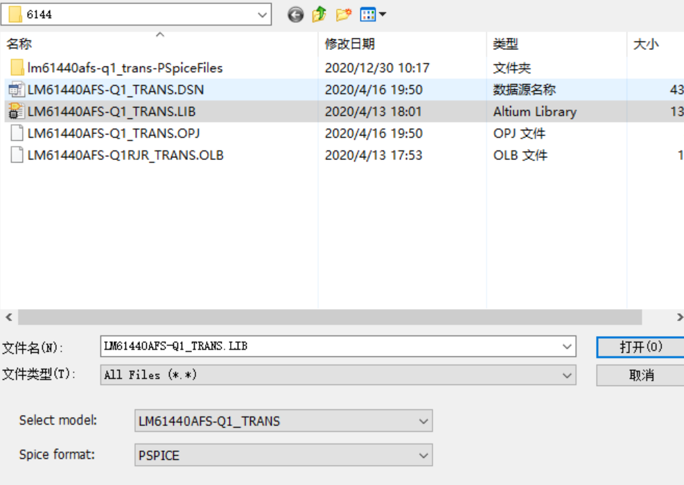

Error while interpreting sub-circuit for block SPICE1:
Parser error:
Undefined type of circuit element ($CDNENCSTART_ADV2).
Context: $CDNENCSTART_ADV2
1 error occurred.

The model download from web is a Zip file, and I choose the xxxxx.lib and  6144_tran model, just like the picture below.

    As of right now, I would say that this model file doesn't work with CST program.
