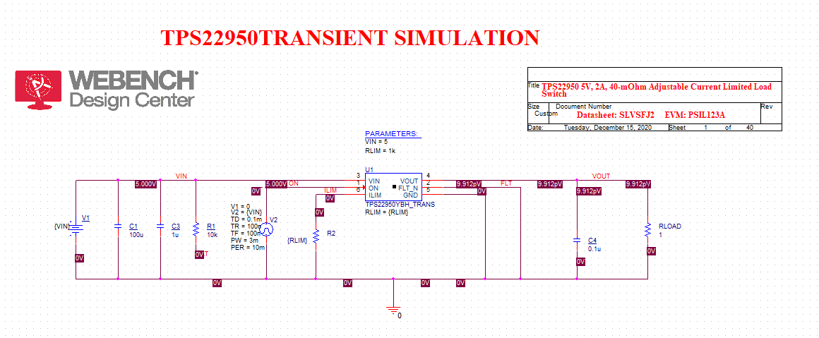

Not sure if I'm overlooking something simple in the datasheet, but I'm ultimately just trying to replicate the behavior found in Figure 9, the "Application Curves". Here with a load current of 3.3V/1Ohm = 3.3A, all I see at the output is ~500mV, and the FAULT_N line is still at 1V, despite the over-current condition. Note that R_LIM is set to 2.21k for a current-limit of 500mA, according to the datasheet.
V2 is mimicking a logic HIGH on a GPIO signal. I tried setting the current-limit explicitly through a 2.21k resistor, but that doesn't affect the simulation results in any way.
Any advice as to fixing this issue? Appreciate any help, thank you.

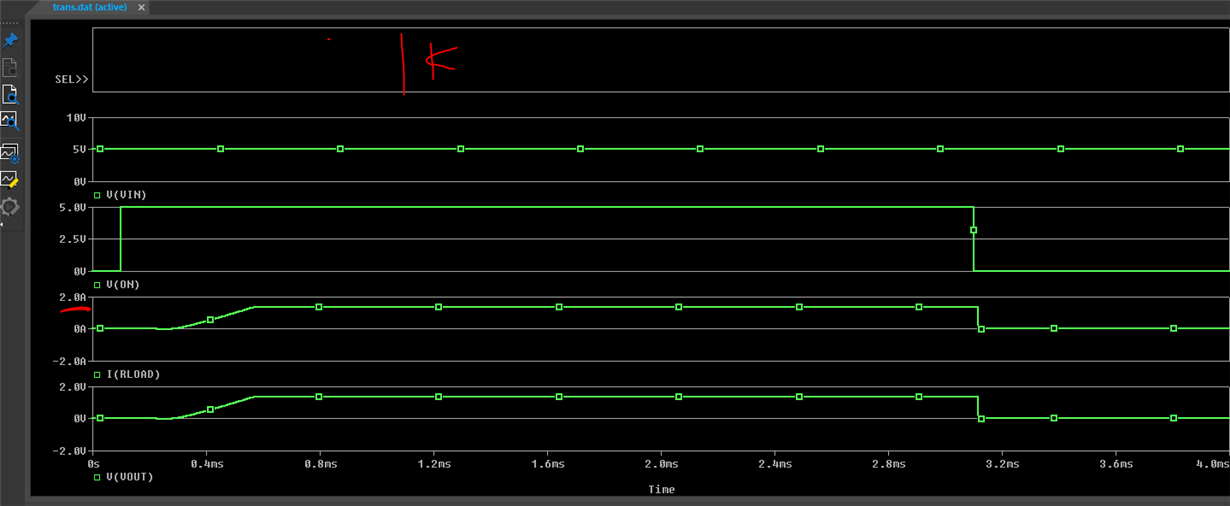

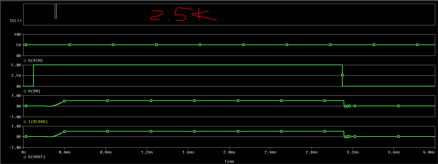

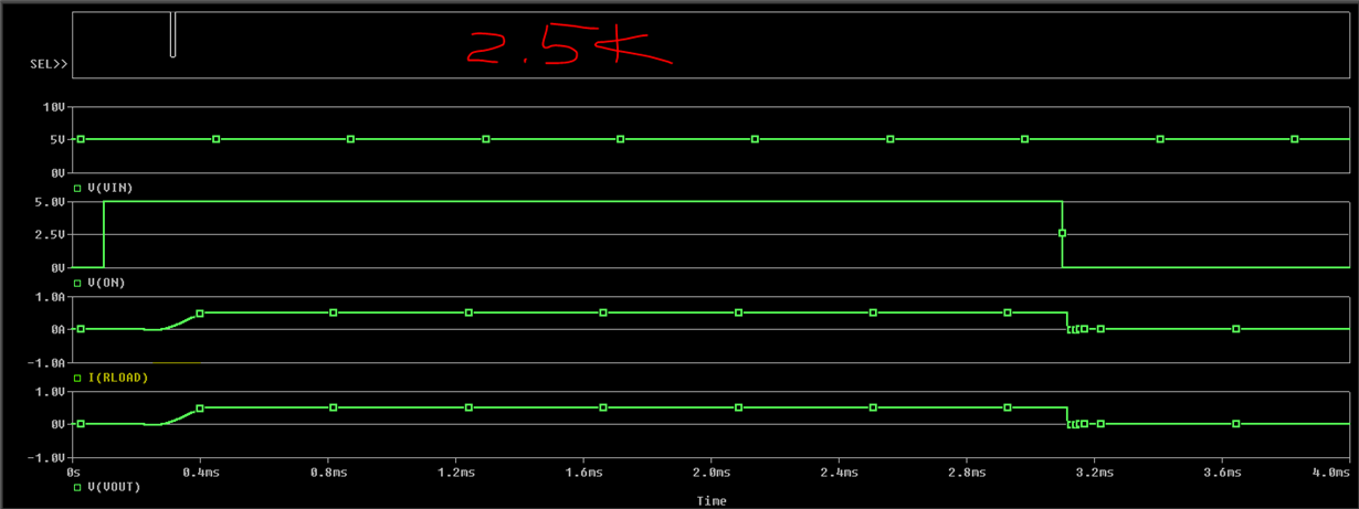

    I have just simualated something close to your setup (1ohm load, 5V VIN), and varied RLIM from 2.5k to 1k. Current limit of the model is working correctly.
    Are you able to use PSPICE for TI? This may be a lot quicker than dealing with LTSPICE.

  • Also,
    In my testing, even when current is limited, FLT line stays at 1V regardless. This could be issue with model itself rather than simulator.

  • Hello again,
    Thanks for your clarifications, I wasn't aware of the incompatibility issues.
    After learning how to actually use Pspice for TI, I came across the same issue with the fault line still being stuck at 1V.

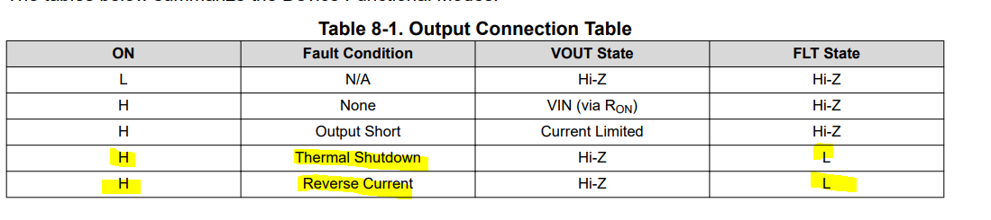

    I'm not sure whether you can confirm that the TPS22950 specifically  has no fault reporting in the case of over-current? It seems that it only reports faults caused by exceeding a temperature threshold; refer to the image below.
    If that's the case (that it has no fault reporting due to over-current condition), how would you suggest reporting such a fault to something like a microcontroller? I was thinking using a conventional current sense amp, but any other suggestions are appreciated.
  • Sebastian,
    You are correct. Overcurrent itself will not trip the FLT pin.
    Only thermal shutdown or reverse current condition will cause the FLT pin to fall. The truth table 8-1 shows the flt state according to input conditions.
    if you need fault reporting during current limit this MUST be implemented externally or you must choose another device. I think choosing another device would be the simplest solution. Especically if implementing on PCB. Other devices can add even more functionality than that as well without increasing the pcb area/bom cost/count..
