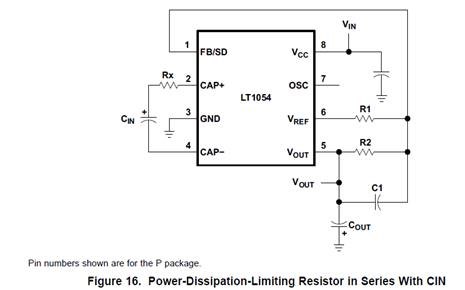

Hi Support team
in case, i would like to convert from 5V to -12V
May just calculate the value of R1 and R2? Do I need to go to the ground when OSC is not in use?
Hello Red,
Sorry for the late response as I was out of the office during Christmas season.
In the configuration you show above, the most negative output voltage of the LT1054 from VIN = 5V is VOUT = -5V (+ some voltage drop).
So you cannot regulate to -12V with the above configuration. You need then an input voltage of at least 13V for full output load.
If you only have 5V input voltage available, you need to use a voltage tripler to get to around 13.5V and then you can invert it with LT1054.
Maybe you might have a look at TPS63700 for -12V from 5V input voltage.
