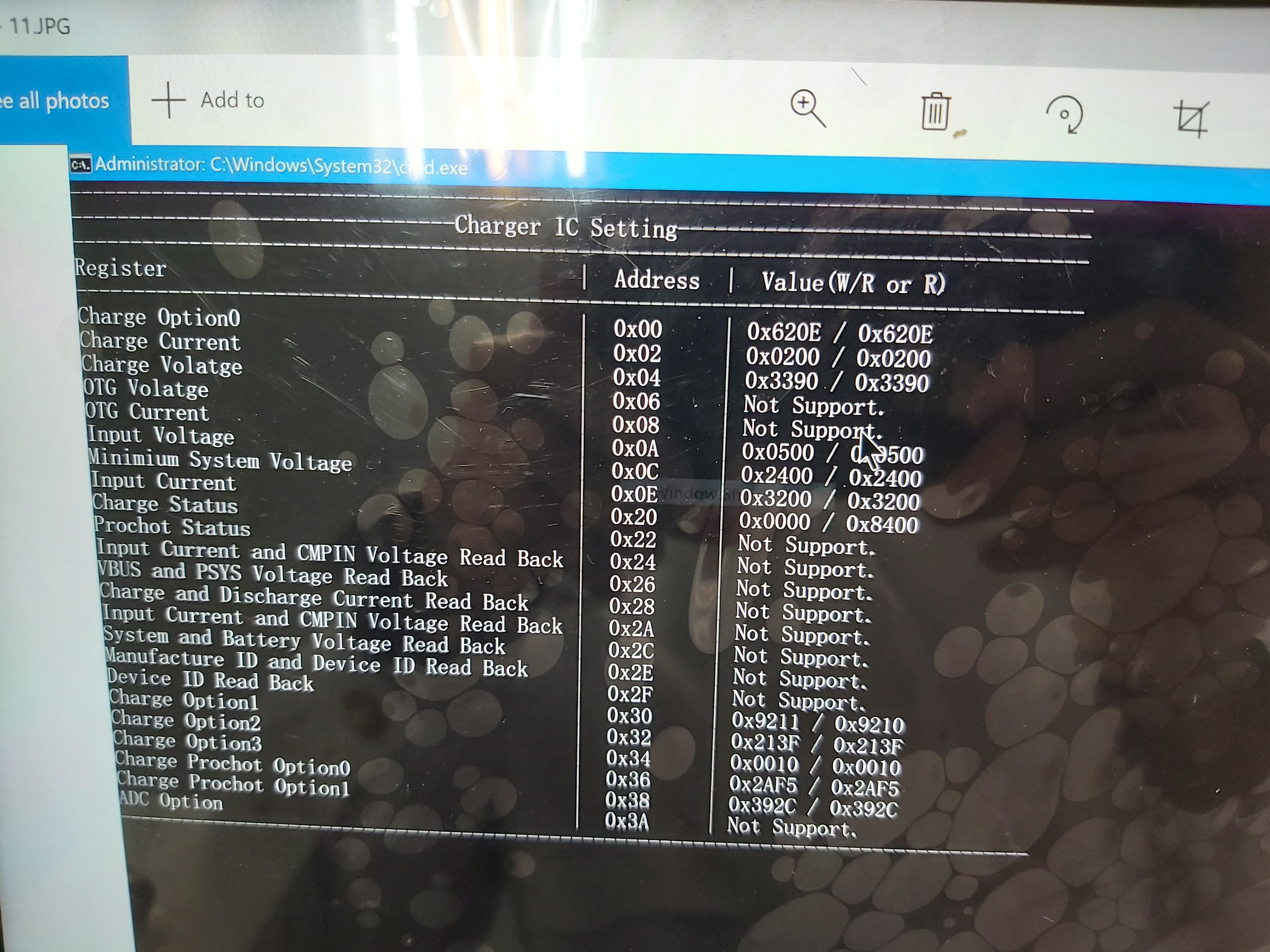

There's one specific board using BQ25713 that HIDRV1 & LODRV1 are not switching for unknown reason with related information as below. Do you have any thought for the potential root cause?
Antony
