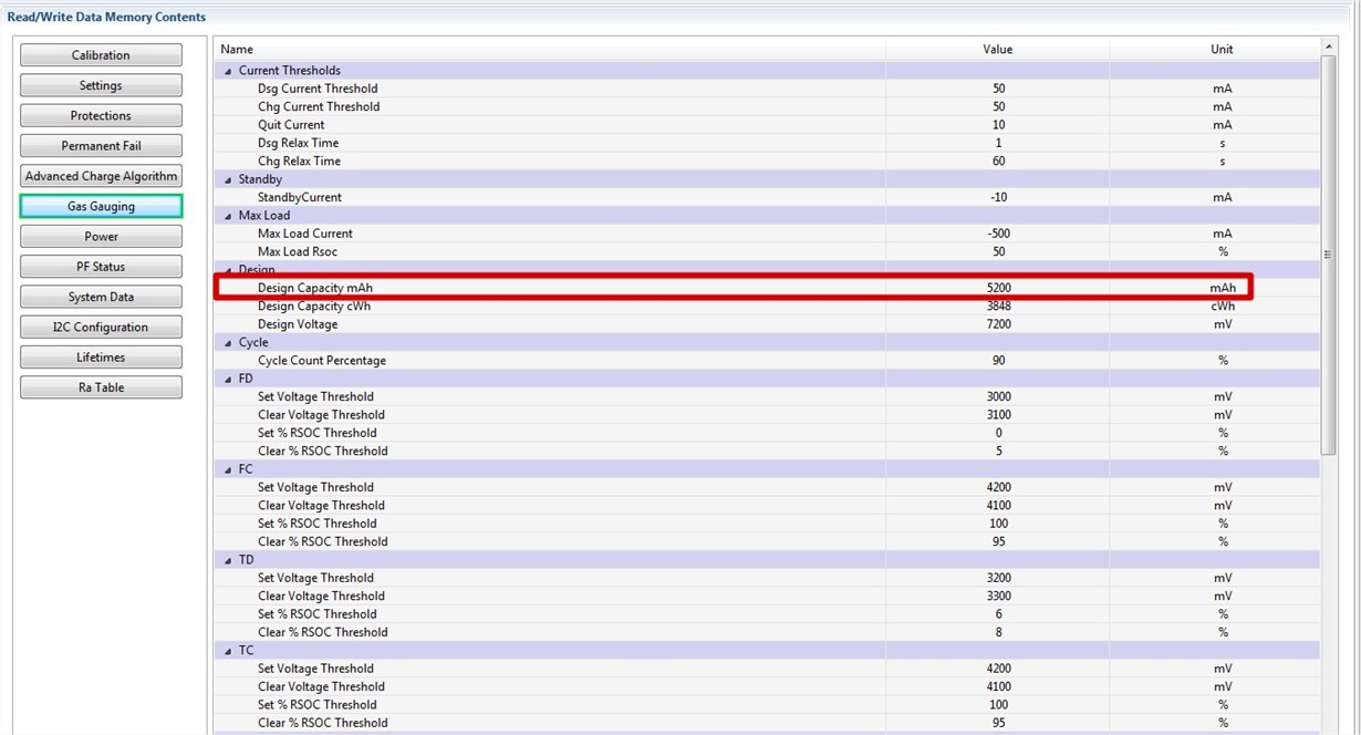

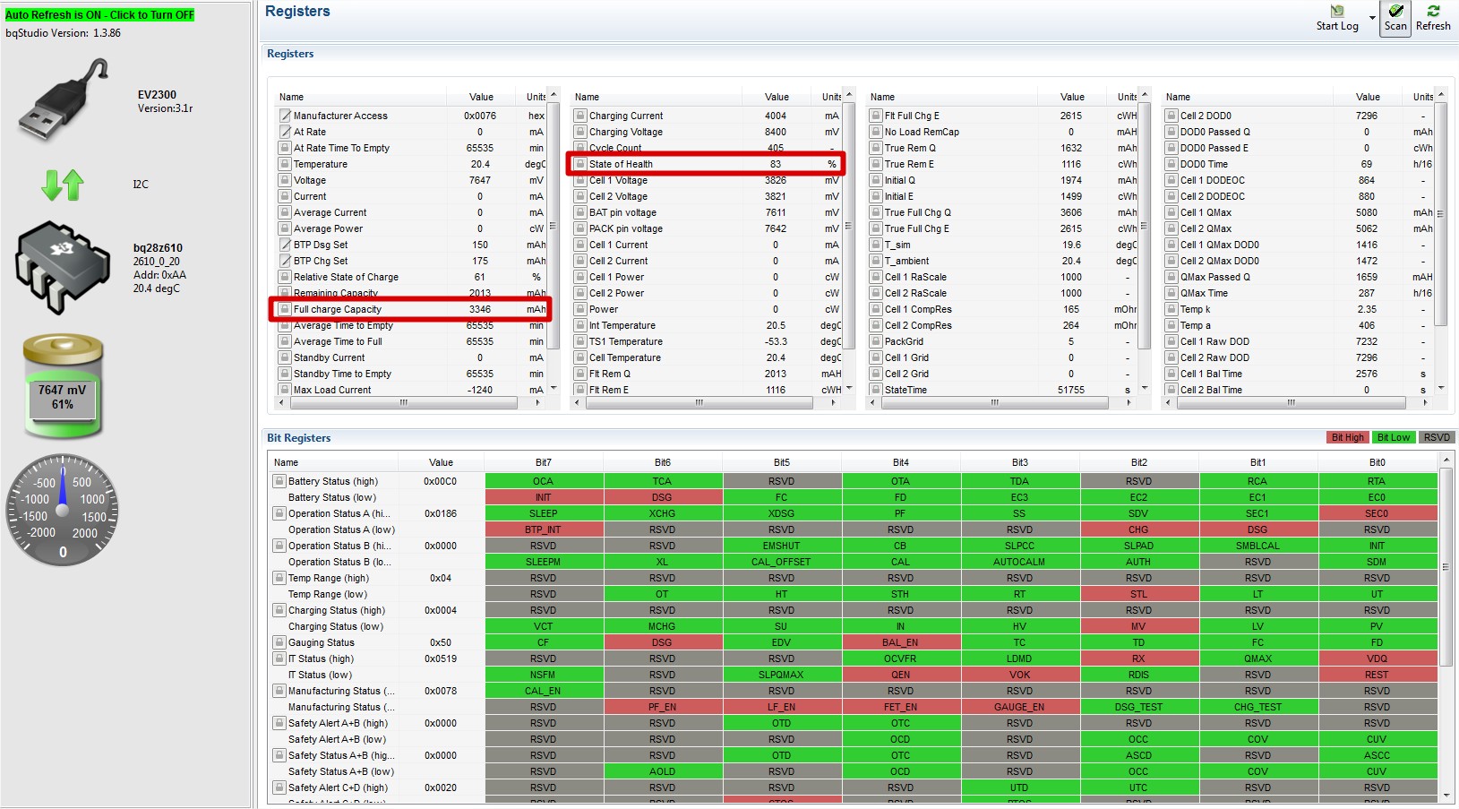

I have a battery pack with BQ28Z610.
The design capacity is 5200mAh, I checked FCC is around 3346mAh.
Based on calculation result, the SoH should be 64%, but I saw register table SoH is 83%.
Why SoH didn't update to 64%?

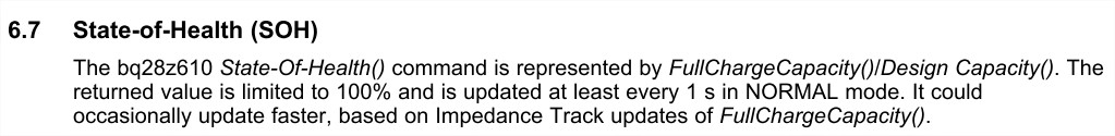

Hi Nick,
Thanks for your reply.
I already choose correct chem id and finish learning cycle for this battery pack.
I know FCC value based on many parameter to predict such as impedance, temperature, voltage and current.
From TRM6.7, the SoH is FullChargeCapacity()/Design Capacity().
FCC is 3346mAh and design capacity is 5200mAh.
Thus, the SoH should be 64%. My understanding is correct or not?

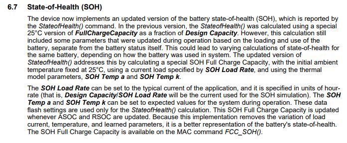

Hi Jason,
Where did you get that snippet? The current bq28z610 Technical Reference Guide includes the following snippet:
Hi Jessica,
Long time ago I download BQ28Z610 TRM from TI website, so the SoH description copy from C version.
I will study it with D version.
