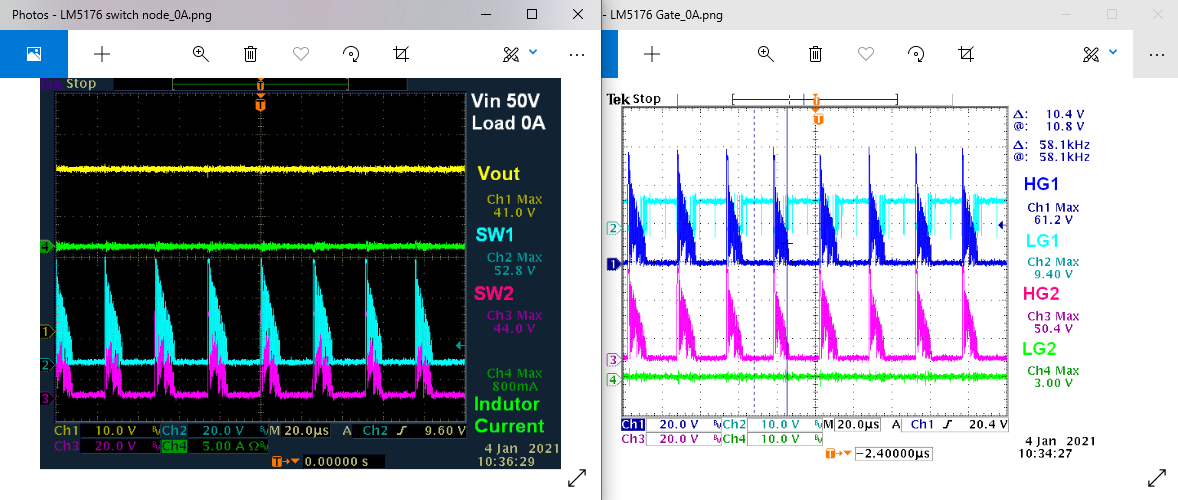

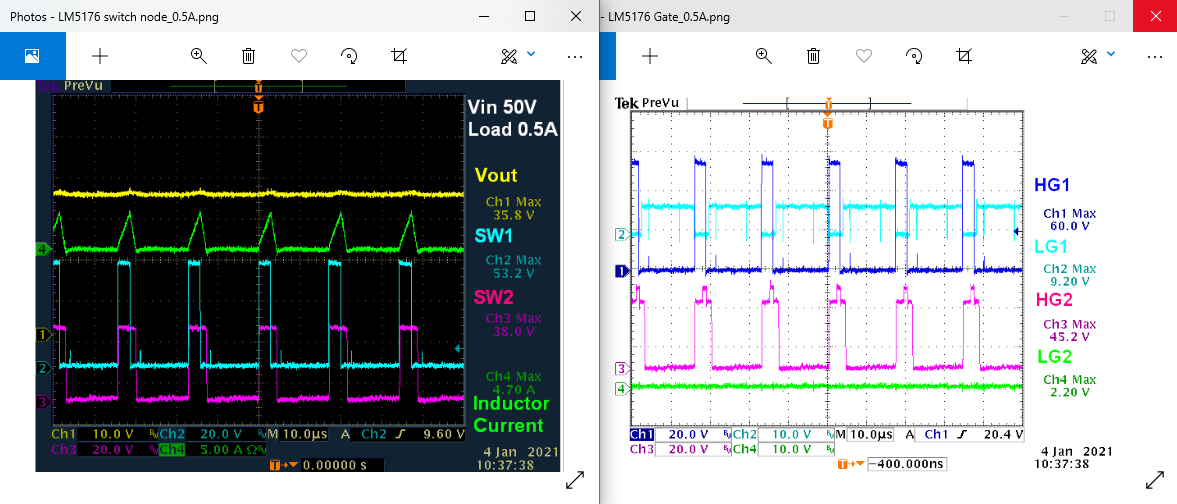

Waveform:
50Vin , Output Load 0.5A
50Vin , Output Load 0A
  • Re-post for waveforms.
  • Hi Aska,
    Could you replace the IC and retest?  The waveform appears incorrect with a good IC.  The circuit should be in the buck, and boost, alternative switching, but your SW1 and SW2 almost move together and this is not right.
    Youhao Xi, Applications Engineering

  • Hi Aska,
    Your scope picture really confused me.  Like in the first picture, if LG2 (i.e. LDRV2) does not switch, SW2 will not move to low but stay as a straight line.  Please double check if you have the right connection as shown in your posted schematic, or if your probe was placed at the right circuit node.
    By the way, is your output voltage at the regulation setting point?
    Youhao

  • Hello Aska,
    If there is no load on the output and your output voltage is not at the set output voltage, something is not working properly in the design. Would you please check if the output voltage is at the desired output voltage at different input voltages with no load.
    BTW, as the output voltage is fairly below the required output voltage and the input voltage it is normal that the lower transistor on the boost side does not switch.
    Is it correct that the circuit is simulated with pSpice? If this is the case it should work as well in your design. I would recommend to order an EVM, replacing the components with yours and check if it works on the EVM layout.

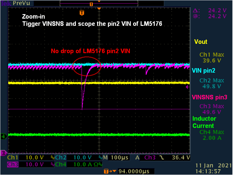

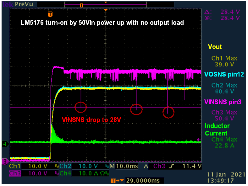

    BTW, I found a problem while I study my PCB.
    The VINSNS pin2 is drop. Could you please provide some suggestions after you reviewed my test waveform?
    Thank you so much.
    Aska
    TEST1: LM5176 turn-on while 50Vin power up.
    TEST2 - I tried to rework the CS/CSG trace by jump wire.

  • Hello Aska,
    From VISNS to SW1, the voltage drop across the top transistor is measured. Can you please measure the current through the inductor when this happens? In addition, please review the connection of VISNS for possible injections or problems.
  • Dear Brigitte:
    Appreciated any input about LM5176 from you.
    About the waveform (inductor current during VISNS drop), please refer the previous waveform-2 (Zoom-in, Trigger VINSNS and scope pin2 VIN of IC).
    Actually the inductor current is around zero during VINSNS drop.

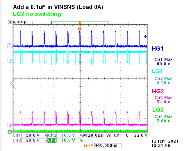

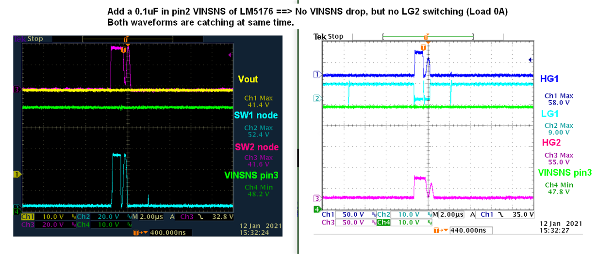

    Today, I have another result. If added a cap (0.1uF) in VINSNS pin3 of IC, the VINSNS drop is disappeared. But no LG2 switching. I guess it shall be important key.
    BTW, same value circuit in previous version PCB board. LM5176 is working normally with LG2 switching.
    I will keep looking for the PCB issue, but I hope you provide any direction or suggestion. Thank you very much.
    Aska
    0112Test1-Add a 0.1uF cap in VINSNS pin3 of LM5176
    Result: No VINSNS drop.
    But the LG2 is still no switching.

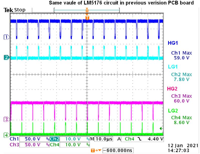

    0112Test2- Test same value circuit in previous version PCB board.
    If it is normal working, the LG2 is switching. (Base on same test setting.)
    Of Couse, no VINSNS drop. And the output voltage at no load can be output desired set point.
  • Hello Aksa,
    Please do not add a capacitor on the VISNS pin. The inductor current direction is sensed on this pin, so this will cause regulation issues if there is no load on the output or the output voltage has a transient from high to low load.
    If the old circuit works, please check which components you changed between the old and new circuit. Even if you only changed a resistor, it is good to know.
    If there is absolutely no difference between the old and new schematic, the problem is caused by the layout and I do not see any other possibility than changing the layout closer to the old one to remove the issue.
