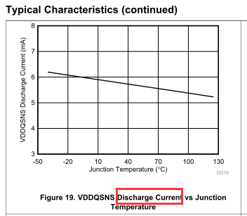

    And help explain what this current means?
    You can refer to the block diagram of datasheet. There are discharge MOS inside IC to prevent the external force voltage. With external bias voltage, it will affect the timing and sequence of the three power rails. So we want to make sure that the bias voltage of each channel can be discharged before startup.
    Using a internal mos for the discharge, all the power will consume on the Rdson of the mos. So the discharge current are both affected with the external bias voltage level and the junction temperature which has effects on the Rdson. The diagram here shows the relation between discharge current and junction temperature (with higher junction temperature, Rdson will go higher and discharge current will become smaller).
    For the 0.62V output request of the VDDQ, I think you can try to use feedback resistor divider from VDDQ to VDDQSNS to get the 0.62V output. There's no obvious concern theoretically.
