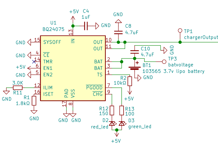

BQ24075: CHG is low but still no current flowing
Part Number: BQ24075
I asked a question before and I changed my design.
The following is happening.
CHG = low (red led is on)
TP3-gnd = 3.96V
iset-gnd = 0v
battery is 3.7v 3000mah
When I disconnect the battery CHG goes high (red led is off).
But when the battery is connected no current seems to be flowing while there should be 500mA pouring in.
This is my design:
Hope to hear from you soon!
