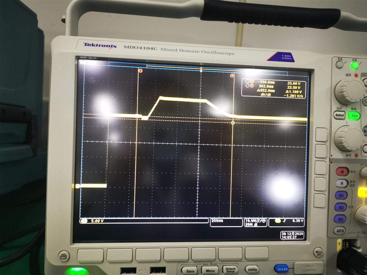

The OVP voltage was reached for a period of time after start-up and continued for 400ms, followed by a normal boost.Waveform is as follows.Please help to analyze it. Thank you very much

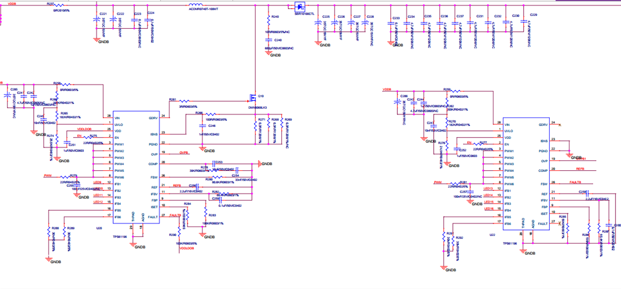

How about the value of the REF capacitor? It may change the soft startup time.

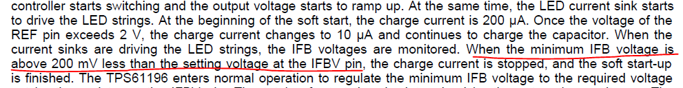

Please refer to section 7.3.5 of the datasheet. The charger current only stops when the minimum IFB voltage is above 200mV, which means the Vout keeps rising until minimum IFB voltage is above 200mV and may reach OVP.

Sorry, I can't view your schematic. Please reload it again by clicking "insert file" button.
Thanks!
