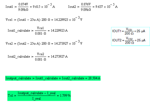

2. the EVM stating the performance of current accuracy to be 1%. however using the EVM in the following test condition. the error seems to be > than 1% (1.79%)
can you help comment on the setup, tweaks?
operate in Buck mode (Vin = 48V, Vout = 14.4V, load current 28A (real))
the Iout1_V = 0.874V, Iout2_V = 0.876V

    2. You need to take into account your resistor tolerance:  both the IOUT resistor and current sense resistor.  The datasheet specified accuracy is just the IC error which does not include your external component errors.
