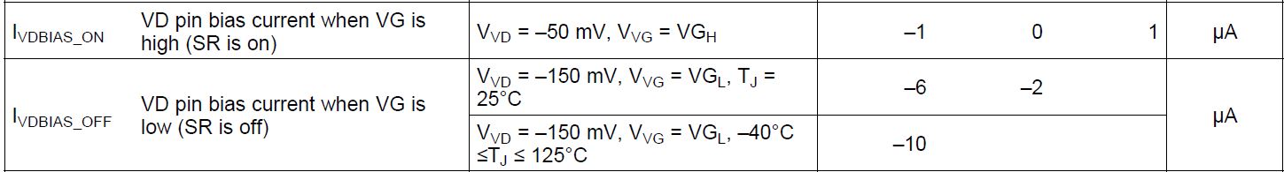

According to the UCC24612 datasheet, minimum bias current on VD pin is 10uA(source) when IC is OFF, will this bias current rise when the temperature rises?
