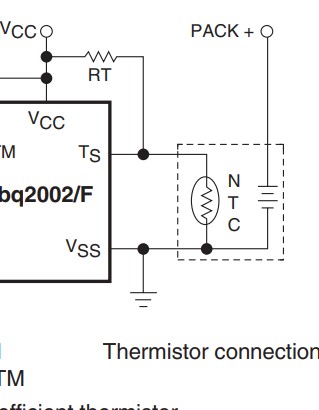

The input power is MICRO USB 5V/0.5A, the charging current is about 200mA,The battery is 2 Ni-MH batteries in series
1.How to set the full charge voltage?
2.How to do overcharge and overdischarge mechanism?
Because it will be used in a car, the temperature will rise to about 80 degrees, how to prevent the charging from stopping when the temperature is high?
The following schematic diagram, need to be adjusted?
    I do not see any issues but the configuration of resistors on the TS pin stands out. The datasheet thermistor connection is as follows:
