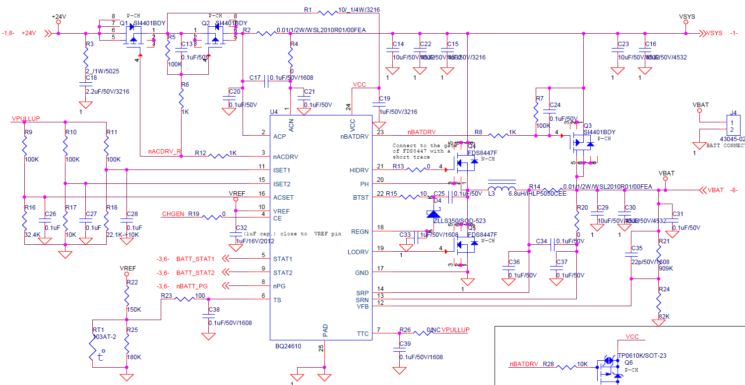

BQ24610: sometimes LODRV FET burns
Part Number: BQ24610
Hi
this is my shcematic

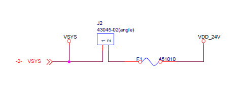

and I'm using rocker switch(J2)
when I turn on rocker switch Q5(LODRV FET) burns sometimes
I tried to change FET(larger Id) to FDS8638 but it's same
1. Is there a problem with the rocker switch on/off noise?
2. How can I select Gate resister value
3. FDS8447 that I'm using has 19~27nC Qg but sis412DN(reference part in BQ24610's datasheet) has 3.8nC. is this not good that has large Qg?
if you have another solution tell me pls
