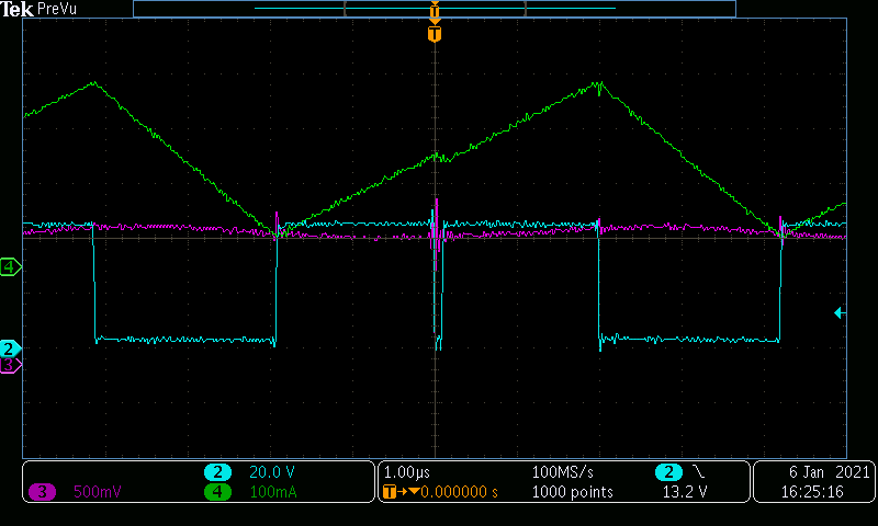

Hi Team,
The customer used LM5164 for converting the DC-48V  to 28.8V @ 420mA and use a TI webench for design the buck converter below:
They measure the switching pin and also measure the current through to the Inductor but saw the signal shape is completely different by the simulation:
Green signal is inductor current
The blue one is SW pin
Purple is FB pin
They use the 220uH inductor from Wurth (MPN is : 74404084221)
In output they don't have any resistor series with the capacitor, just have a 4.7uF
Please let me know your comment or any question to the customer to resolve the issue.
