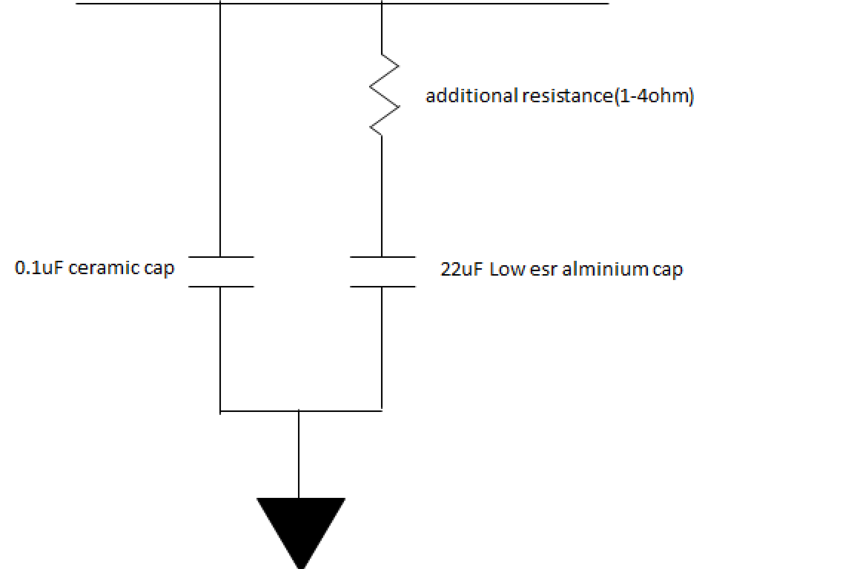

Hi support team.
My customer has an oscillation problem in the TL1431 circuit.
When the ESR of the output capacitor is set to 100 m ohm or less, it oscillates and stabilizes at 1 ohm or more and 3 ohm or less.
They have confirmed that it oscillates again when the ESR is set to 4 ohms or more.
Could you give me some data or resources on ESR stability conditions? (Is it somewhere just because we can't find it?)
Also, I would like you to check our schematic, is it possible?
If yes, it is not allowed to be open to the public because of the customer's circuit diagram, so can you send me a private message?
Let me know if you have any question.
Thank you for your cooperation.
