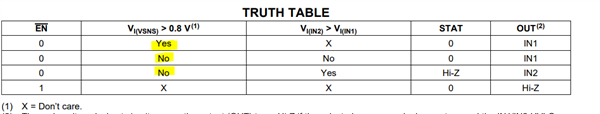

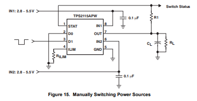

Our team decided to use TPS2115ADR as Power-OR solution for the board we are making. We decided to use the Manual Switching mode as demonstrated from the datasheet (image 1)

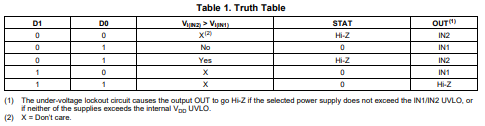

and using this truth table
From our understanding, the 1st and 4th row applies to manual switching mode.
We decided to use IN1 as the input to D1 such that, when IN1 is connected, D1 is pulled HI to IN1, and IN1 is chosen as OUT. However, when IN1 is not connected, if my understanding is correct, D1 is still pulled HI because of the internal pullup and thus will still choose IN1 (based on the truth table). So we wanted to make sure that D1 is either pulled HI to some voltage, or pulled LOW to follow the truth table.
From the image below, we decided to implement a voltage divider (R1, R2) that supplies D1 when IN1 is connected and Pulled LOW (via the divider resistor R2) when IN1 is not connected. For reference, +5VDC:external supply; VBUS:5V from USB; and +5V is the output voltage. We want to prioritize external 5V (+5VDC) when it is present.
We are aware that the D1 can sink current as stated below. Our concern is the values of the resistor we could use to make this work. From my understanding, the resistor should be high enough to avoid sinking high current but must not be too high so that R2 works as a good pull-down resistor when IN1 is not connected.
Can you recommend values for R1 and R2 (or at least the order of magnitude) if I want to operate the D1 at at least 3.3V when IN1 is connected and pulled LOW via R2 when IN1 is not connected? Other comments are also welcome.

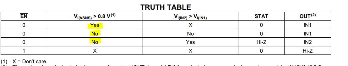

  • Some images above seem to be displayed incorrectly, here they are in order, they are from the datasheet

    TPS2113A truth table is shown below. You can make a single resistor divider to VSNS and have exactly the functionality you want which is a better solution overall than using TPS2115. If you prefer the more robust and modern TPS2121 this will have the same functionality that you need with more features.

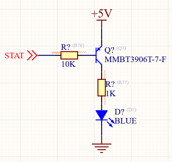

    I considered the TPS2121. Thanks. I would just like to ask if the circuit below would work as intended. I am using the XCOMP mode of the TPS2121, which means the ST pin is pulled H when IN1 is the output, and pulled L when IN2 is the output. I designed the simple circuit below that will light up the LED when IN2 is in use. The LED has Vf=2.8V, If=2mA. The PNP BJT has VCE,sat=0.4V Max, VEC,on = 0.95V and can drive up to Ic=200mA.

  • Ramon,
    This circuit is exactly what we would recommend for LED indication from ST pin.
    THis will work fine.
    Best
