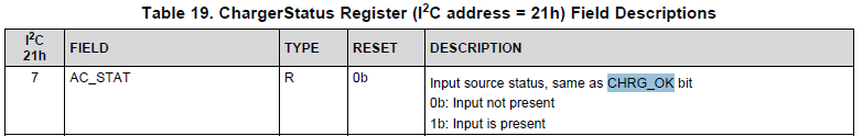

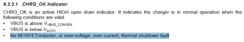

1. As I read from 9.3.3.1 section, CHRG_OK pin goes LOW and on Fault condition. Is there any way I can distinguish an input power problem from a fault problem.
2.  Or can I use AC_STAT flag of ChargerStatus register for example? Namely does AC_STAT equal to '0' when a fault occures?
3. Or maybe I should read the bus voltage, and if it is greater than V_VBUS_CONVEN = 3.5V and I have CHRG_OK pin LOW means that a fault has occured.
4. Can I get more information on the cases when CHRG_OK pin goes LOW apart from the input voltage (V_VBUS_CONVEN and ACOV = 24V)?

  • Hi Di,
    Your understanding is correct! Option #3 is a better approach to separate other faults. Datasheet section 9.2 also describes CHRG_OK function.

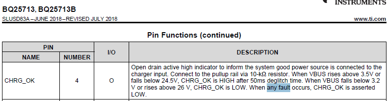

  • As written in the "Pin Functions" table, "any fault" will cause CHRG_OK to be asserted LOW. Could you specify please which faults exactly will trigger CHRG_OK pin LOW? What is the corresponding Fault_flag in the Charger_Status status or other register?
    Please, I need an exact answer since I am designing an autonomous charger using BQ25713. This charger will be working in remote places, where sometimes people cannot even reach to manually do some action on the charger. So I have to be sure that the charger won't just be stucked because of some fault that I don't even understand.
    Please do your best to provide a complete answer on the meaning of CHRG_OK pin asserted LOW, since I can find such an answer in the datasheet.
  • Hi Di,
    Datasheet 9.3.3.1 is the complete list of faults that will trigger CHRG_OK low.
    Linhong
  • Dear Linhong,
    OK, I understood. Since MOSFET/inductor fault and thermal shutdown fault do not have a corresponding alarm flag in the StatusRegister, I cannot detect UnderVoltage event by just excluding all other Alarm flags of the StatusRegister. So I have to detect the UnderVoltage event by reading the BUS voltage, as you sujested.
    Thank you for your support.
    Dumitru
  • Hi Dumitru,
    Correct!  you need extra information to exclude other scenarios.
    Linhong
