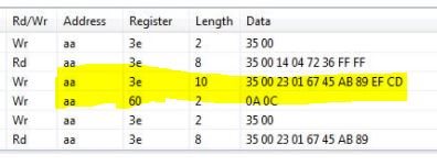

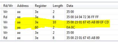

It looks like you are not performing the second command for the checksum.

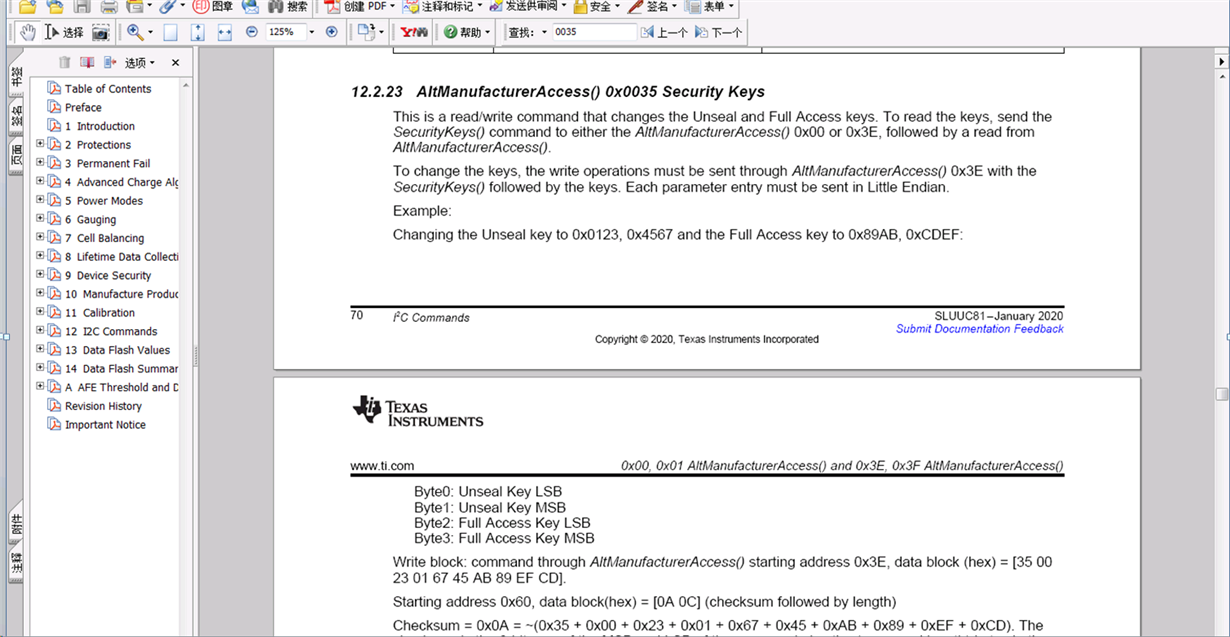

"Starting address 0x60, data block (hex) is [0A 0C] (checksum followed by length)
Checksum = 0x0A = ~(0x35 + 0x00 + 0x23 + 0x01 + 0x67 + 0x45 + 0xAB + 0x89 + 0xEF + 0xCD). The final checksum is the bitwise inversion of the result"

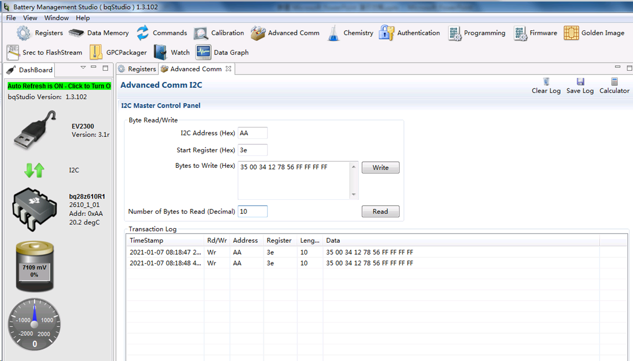

I have tried the operation in TRM, but it was not successful. Can you provide a screenshot or instruction of successfully changing the initial password
Thank you very much for your help. After many attempts, I finally succeeded. The key to success is to send these commands in a short time. The success of one-time modification is very low, you need to use the microcontroller or host computer to send commands, the success rate should be higher
