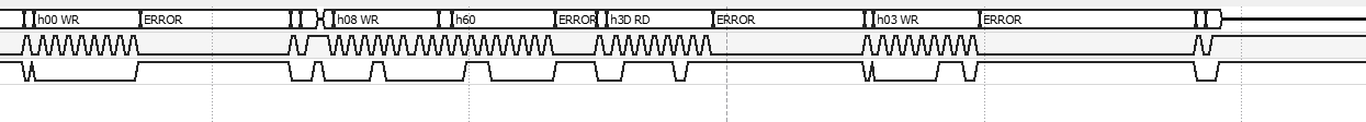

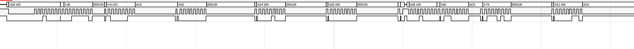

    I'm attaching the waveform for the command to balance cell 1 and another to balance cell 4. Cell 1 works and cell 4 doesn't Is there anything missing in the waveform.
    setting cell 1 to balance (which works)
     setting cell 4 to balance (which does not work)

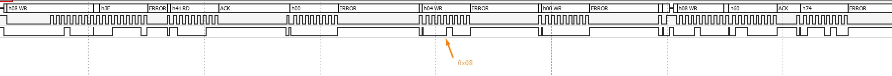

  • Hi Eohan,
    The waveforms are a bit interesting to read.
    When sending the cell balance command for 1 cell following the guidance on subcommands in the first paragraph of the technical reference manual I would send 08W 3e 83 00 01 00.  Then 08W 60 7B 06.  The 06 comes from the description in the next to last sentence of the paragraph 3.1 of the TRM: "The data length includes the two bytes in 0x3E and 0x3F, the two bytes in 0x60 and 0x61, and the length of the transfer buffer."  The checksum is calculated over the 4 bytes 83 00 01 00.
    The second waveform sequence you sent seems to be 08W 83 00 04 00 then 08W 60 74 03.
    The checksum would be the NOT of the sum of  83 00 04 00 (sum = 87).  NOT is 78.  So it would seem the 74 you are sending as the checksum for this command is wrong.  From the success with the first sequence apparently the part is tolerant of the length difference, but I would recommend the guidance of the technical reference manual.
    1. The waveforms seems right. The logic analyzer does not accurately decipher the numbers sent. If you look at the waveform they correspond to the right numbers.

  • Hi Eohan,
    Again direct host control of balancing is not dependent on balancing.  The parts were tested in development and found to work.  Parts are tested in production.  If the part you are using might have been damaged, change it.

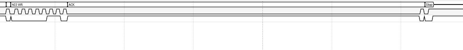

    In  your waveform I see the analyzer does sometimes miss interpret the waveform.  For example in the "cell 4 to balance (which does not work)" the command 0x83 looks like 0x83 in the waveform although the display says h41RD.  The checksum I calculate should be 0x78, but later in the waveform it shows 0x74 sent for the checksum byte. I see the length byte sent is 0x06.  I think you are describing intermittent success.  I don't know why or how checksum generation could be intermittent.
    Other than the wrong checksum, if your analyzer is having trouble understanding the waveform, could the waveform have artifacts which make it difficult for the IC to understand as well?  Waveform sensitivity could certainly be intermittent.
    <deleted message structure commment, length seems correct in the one checked>
    The data that is sent in the second waveform sequence is 08W 83 00 08 00 , the byte in picture is 0x08 not 0x04. So that should be the correct data. Please note that the analyzer is not detecting the right numbers for the waveform.
    The I2C lines look very clear on the oscilloscope.

  • Hi Eohan,
    "Again direct host control of balancing is not dependent on balancing."
    I'm not sure if it was an incomplete thought or an attempt to say that with host balancing what you write is what you get to balance.
    I do see the sequence now and confirmed that 08W 83 00 08 00 followed by 08W 60 74 06 balanced cell 4.  It balanced until the timeout, it balanced at 4017 mV, 4022 mV and 4036 mV as well as several other voltages between 2 and 4.4V.
