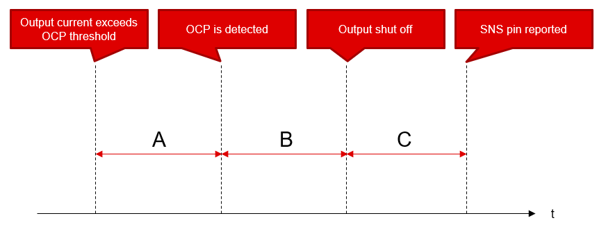

    Could you confirm me my whether understanding is correct or not? In addition, do you mean duration A (or OCP deglitch time) is not specified, is it correct?
    Duration A: How much time is it required?
    Duration B: Fast trip response 7us from OCP detected to output shut off
    Duration B+C: SNS pin reported response 50us
    Ochi
  • Above figure is for reference for my questions

  • Hi Yoshiki,
    Current limit accuracy for the High Side Switches is different for instantaneous over-current events and slow current creeping events. When the current limit is detected instantaneously when the FET in the current mirror is saturated by a fast increment of load current. However, for slow current increase this FET will remain in the linear region affecting the current limit accuracy. The following application note, section 4.1 refers to this issue more in dept.

  • Hi Ochi,
    Your understanding is correct with this device. The device accuracy should not be affected by this slow current. I am asking internally to see if there is a way to obtain this data. Another option I am considering if to try to measure this time on the lab and provide you a reference value to consider when using the devices. I should have an answer here shortly.
  • Hi Ochi,
    I was able to get some answer for the questions here.
    A = will be a 3us current limit trip to maximum value.
    B = Depends on what conditions you have. The FET turn off will follow the slew rate control as defined in the datasheet.
    c = Correct, 50us should be the expected value here.
    I hope this answers this question here.
