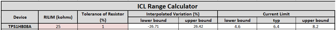

    The following image is taken from the calculator excel sheet I referred on my first answer. Its is important to understand the calculations, but I would definitely recommend using this calculator in order to obtain the accuracy values.
    Note: The table shows typical values and the accuracy based on lower and upper bound. Using the assumption that you are using 1% tolerance resistors. This calculator can be found in the web page for the TPS1HB08.
    - For the higher current limit, higher accuracy question
    The table bellow shows the accuracy with lower typical current limit and higher typical current limit. The first image shows the accuracy you will obtained by setting the current limit to its lowest value. The second images shows the accuracy by setting the value to the upper bound.
    As you can notice, the accuracy increases by setting the current limit to higher values for this specific version of the devices. Using the table will give you a good understanding for your design when using the devices for different current limits. This may vary for different devices and different version of the devices.
