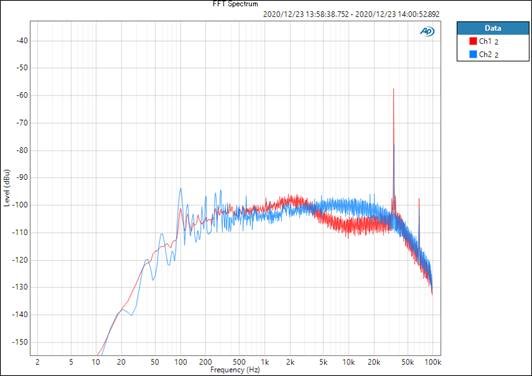

    I attached FFT waveform below.
    These noise is not hear by human, but inaudible noise occur on lower 50kHz.
    One customer is afraid to failed the measurement test by noise.
    If there way to suppress these noise, please let me know.
    Satoshi
  • Hi Saoshi,
    May I ask you some questions:
    1. Since human can't hear the noise of 50khz , why your customer still concern about this frequency ?
    2. What test standard requested to test noise at 50khz and can you tell us what is the frequency test range of the standard.
    3. Think about that :  even if we can push the burst frequency higher than 34khz, such as 100khz , we still don't know if the customer has some concern on 100khz.
    Anyway,  when we define the burst frequency range 25khz ~34khz,  it has already higher than human can hear 20-20khz with some margin. it is fixed by controller, we can not help you to change it . the way to suppress the noise is another topic . firstly you have to find out the source if noise , is from transformer or is from MLCC ? before that , we should to know if it's a real issue or it just a concern .
    Thanks.
  • Hi Jaden
    Thank you for reply,
    I will confirm about the reason of noise, transformer or MLCC.
    Specifically, customer's condition is High resolution audio, these application is expanded frequency range of 50kHz.
    Actually human feel to hearing clearly and no trouble, but possibility to mention the concern point by customer internal measurement test, because its noise sensitivity application.
    Satoshi
