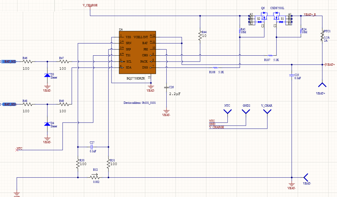

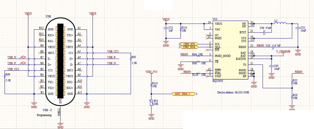

    I have designed schemes to safely charge and discharge batteries. The charger sensor is BQ25619 and the fault protection sensor is BQ27750.
    I have tested and have only encountered one problem that I described before. But I am not sure in production it will be stable. Could you help me review the schematics? Is it well designed? Do you have any advice for my design?

    This is my design schemes to safely charge and discharge batteries. The charger sensor is BQ25619 and the fault protection sensor is BQ27750.
    Thank you.
    The design looks fine to me, this issue is related to the CUV threshold you have selected which is very close to the max charge voltage in terms of the diode drop of the body diode. The battery voltage needs to be greater than 4.2V-0.7v (diode drop) or 3.5V to charge. It looks like this is the exact voltage for your threshold so it may not charge depending on the diode drop.
