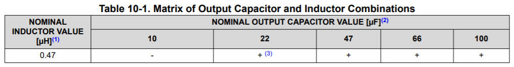

Datasheet is described L and Cout recommend value, attached below.
Can L and Cout value exceed recommend range, no problem? (For example, L: 2.2μH~ and Cout: 200μF~)

・I guess that datasheet recommend value is the condition of stable with TPS63802's internal compensation specification. (is it correct?)
 If my guess is not correct, I will consider to change L and Cout value much larger than recommend value for decrease peak current.

  • Hi Satoshi,
    The LC value can increase according to your design. Usually, the system will still be stable when the value are larger. But when you choose larger value, the size will be bigger. There should be a trade off.
    Another way to improve transient specification is to add feedforward capacitor. The application note below could be a good reference.

  • Hi Yichen
    Thank you for advice,
    I found happy medium for L: 2.2uH and Cout: 47uF ×4, and I confirming to customer about OK or NG the L and Cout value.
    Please wait a few days for customer's answer.
    I addition, Webench data occur large inrush on startup and feel low phase margin, I already suggest to customer about application note for external feed forward capacitor (you attached) and soft start circuit.
