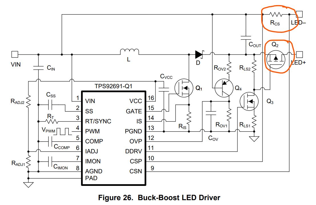

TPS92691: when vin is close to 50V, is there a better place for Rsense?
Part Number: TPS92691
hi ,
my customer uses TPS92691 for laser driver. The vin is 50V. They use "Buck-Boost LED Driver" topology for ~60Vout as below.
they have concern on CSP\CSN. these pins only can take 60V.
Are there better place for RCS to get lower voltage?
Another question, if put Q2 at LED- end, is there any concern?
BR,
frank
