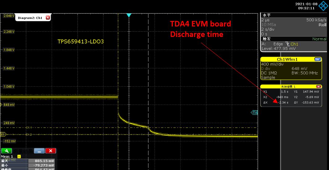

    I have noticed on the LDO3 it takes about 2seconds to discharge.  Are you attempting to power up the device before the regulators have discharged to 150mV?
    Thanks and Regards,
    Chris
  • Hi Chris:
    Yes, I have tried;It doesn't seem to be very relevant;At the same time, I have tested the discharge time of LDO3 of TDA4 EVM board, which is almost the same as that of our board.See the attached illustration for the waveform of EVM board;

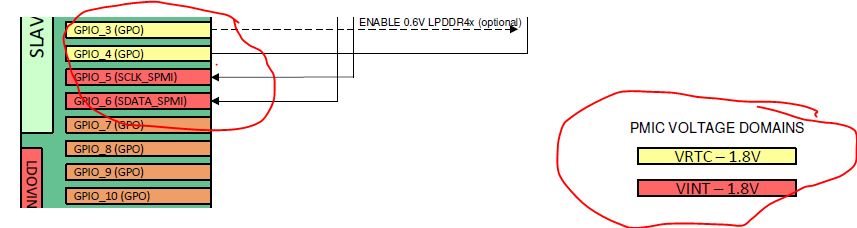

    Another difference is that compared to the EVM board, the power supply of LDOVINT on our board will drop,  I guess TPS65941 is having some kind of corresponding failure; Do you have the FTA of TPS65941 to help us locate the problems corresponding to these phenomena?

    What I am curious about is that even in abnormal circumstances, LDOINT&LDORTC can complete the normal power on;However, I did not see any output of GPIO3 and GPIO4 , 5, 6 after the power-on was completed;
    Accronding to the current situation, I guess this is an initilation failure;

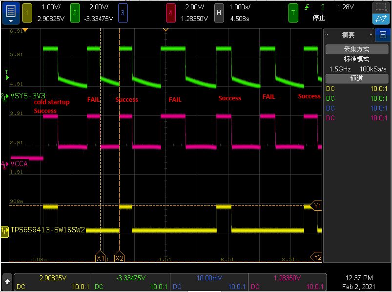

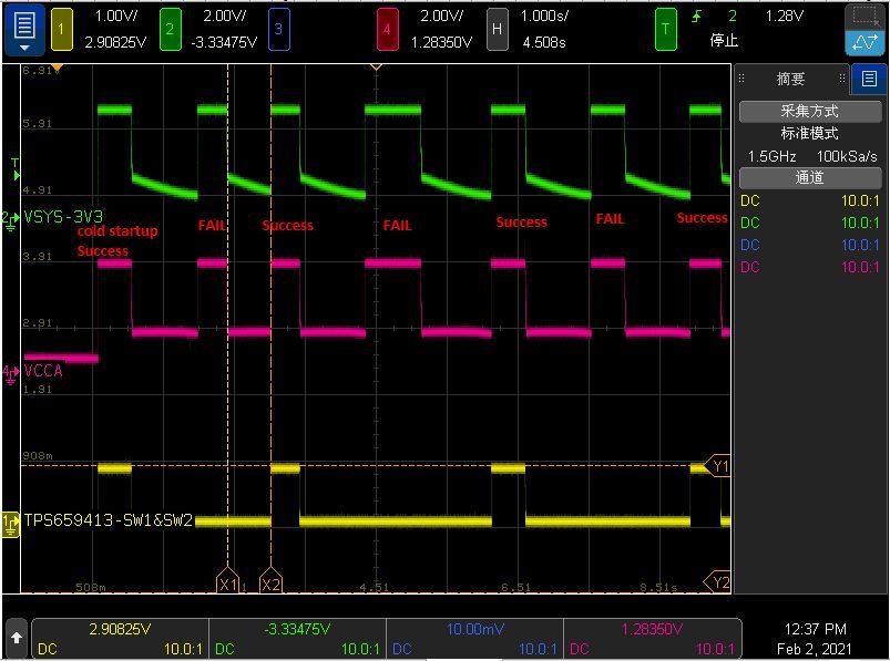

  • Hi Phil:
    1、What's your definition of "always work in 1st power up"?
    ->The definition of "always work in 1st power up" means that it works properly after the first power supply; In other words, it can start normally under cold start conditions;
    2、Do you have VSYS and VCCA scope captures during power up the setup?
    ->As shown in the figure below:VSYS&EN,  and VCCA update later.
    3、If yes, did you see any deep droop which may cause UV or OV?
    ->no, I did not see any drops;
    4、When power up properly; do you see register values read out still all  "0"?
    ->When power up properly,  the register value is nomral;

  • Hi Phil:
    You can see attactment show the PMIC vlotage always fail the second time after a successful startup.I don't think the current problem has anything to do with cold boot ;
    and I guess there must be some kind of funtional safety ERR in PMIC;
    you can see the picture as blow:
    LDOVINT has drop vlotage after startup, and I wonder if those mistakes are related to LDOVINT?

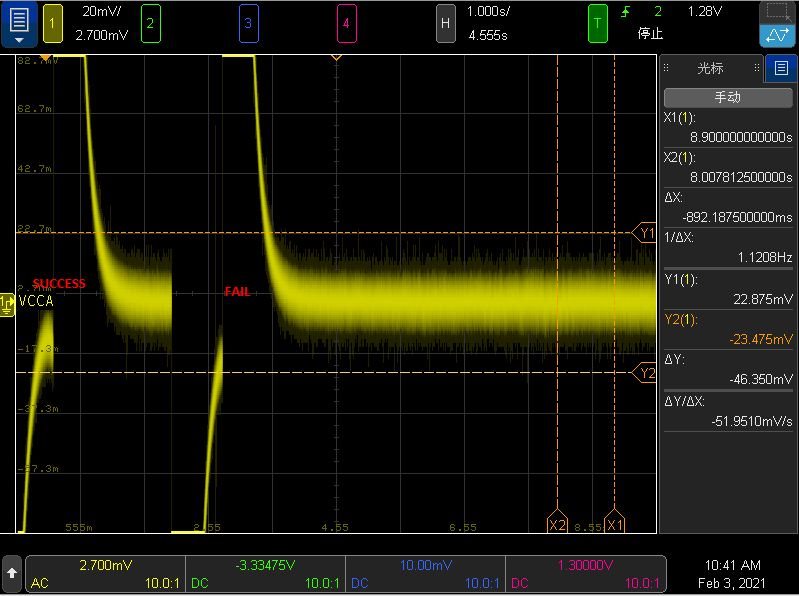

       Would you please try followings?
    1. Rising the VCCA to 3.3V. Your capture shows current VCCA is just above 3V; it's very marginal to power up properly.
    2. Adding more caps on VCCA to get rid of those 100mV ripples.
    3. If possible, please share us PCB layout. It looks like VCCA trace has too much IR drop.
  • Hi Phil:
    you may have misunderstood what's in the picture;
    1、The voltage of VCCA is 3V that you see, and you would be using the residual voltage as a starting point;
    Actually the voltage of VCCA is 3.3V;
    2、I set the VCCA channel of oscillocope to AC gear , and we can see the picture more clearly; The VCCA ripple is 46.35mV;
    3、you can see the attachment:

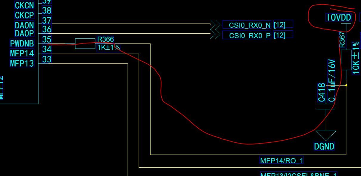

  • Hi Phil:
    I just had Chinese New Years; I've read the registers before and they're all "00";and I have tried the above procedures and have found no significant improvement.
    But I found that by changing the enabling of an unrelated IC(Serdes) I could solve this problem; for this debug, I find it quite strange.
    Ths;
  • Hi, Bill,
      It's great to hear that the issue can be solved by changing the enabling of an unrelated. May I have your kindness to tell me more about "changing the enabling of an unrelated"? Like the power rails from the PMIC to supply the Serdes? Is there other connections between Serdes and the PMIC?

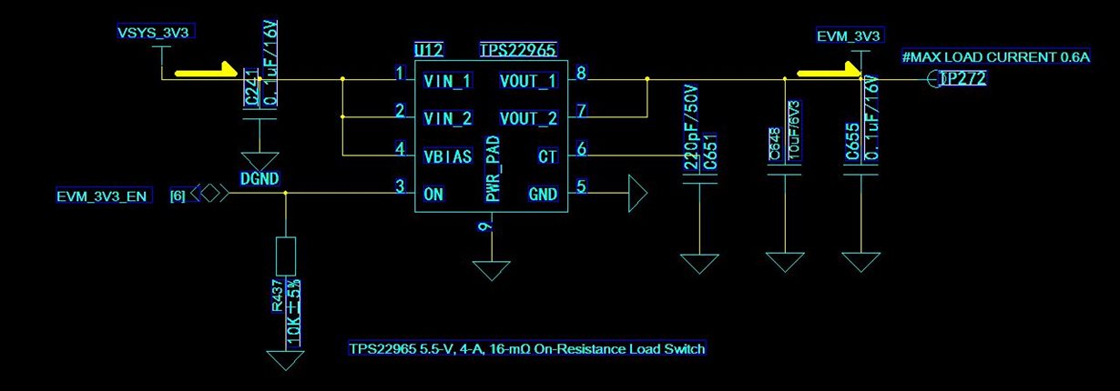

  • Hi Phil:
    From my point of view, there are no connection between Serdes and PMIC; PMIC didn't supply the Serdes;
    The only clue may be limited to this, VSYS_3V3----(tps22965)------>EVE_3v3-----(bead)------>IOVDD-----(RC)------->Serdes(PWDNB);
    and Serdes(EVE_3V3) power on later than PMIC,  I changing the enabling of serdes(PWDNB)  or cut off,  then PMIC will work normal;
    So that's what I'm curious about.
