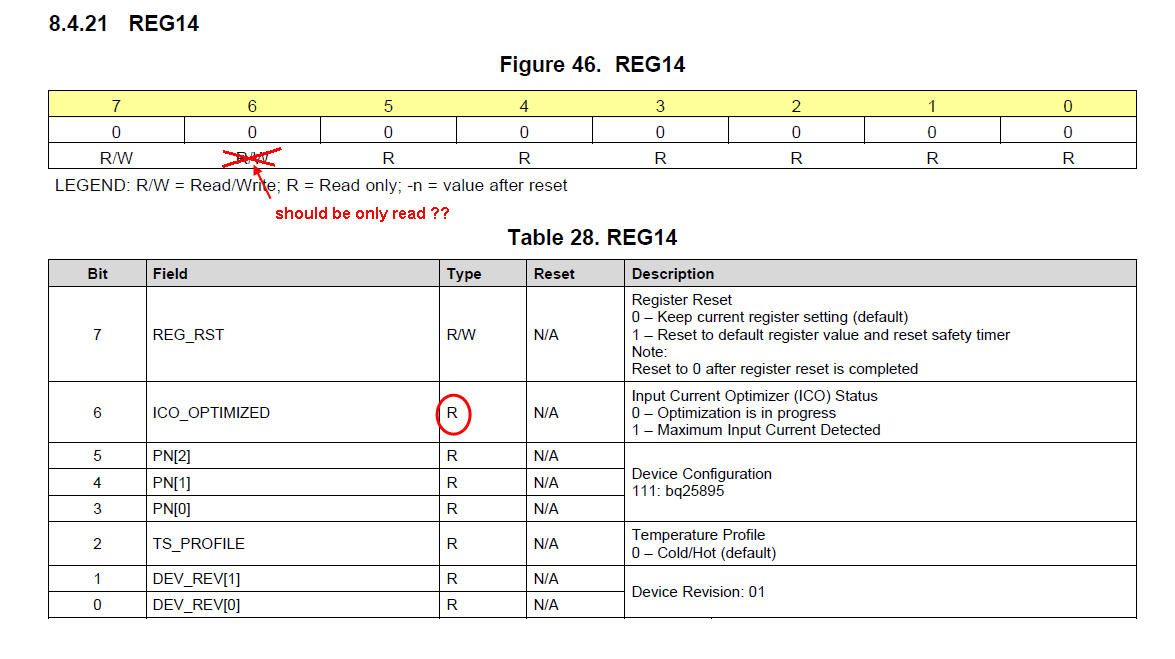

BQ25895: REG14 => ICO_OPTIMIZED bit may be a typo error
Part Number: BQ25895
Dear Team,
concerning the BQ25895 datasheet (SLUSC88B –MARCH 2015–REVISED MAY 2018) page 48 is written about the bit 6 of the REG14 that is R/W, but into the details table this bit is marked read only, I think is just a typo and the correct denomination is only R as written into the details table.
Thanks and best regards.
F.
