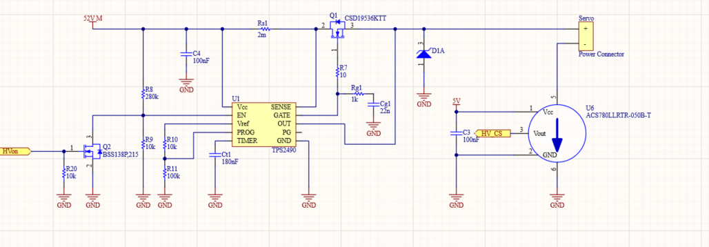

Like the title already asks, we're wondering if this unit does support bidirectional currents.
We cannot find it that directly in the datasheet but we'd like to know. And if not, is there a comparable TI product that actually can?

Hi Nick,
Do you want to have overcurrent protection on both the directions. ?
In general, the body diode of the hot-swap MOSFET allows current flow from Vout to Vin side. After a while, the Vin gets charged and enhances the FET. Is this acceptable ?
Can you share your system block diagram, end application and product details.

Hi Rakesh,
Thanks for your answer!
The point of this is, we're using the HSC (hot swap controller) to protect the system for inrush currents. On this system there are motors which could provide regenerative braking if the HSC's allow for it.
I'm not quite sure a bidirectional protection truly is necessary but the HSC should allow for bidirectional current for as long as the regenerative braking lasts in the most ideal case.

Hi Nick,
Thanks for the clarification.
Since Q1 is fully ON, it allows regenerative current to flow to the supply side. I don't think, you need to modify the circuit.
Please test and let me know if you have any issues under that condition.
