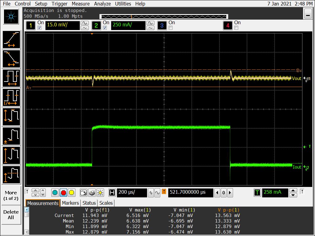

I used TPS74401 to convert 1.8V to 1V and 1.8V to 1.2V design, the max current is 1A for both design.
When probe the bode plot the phase margin is around 38-40degree at 0A load while about 43degree at 1A load.
Can we consider this as stable? if not how to tune the compensation?
Tried to increase the Cff from 100p to 1n or 2.2n, there is minor improvement but still less than 45degree.
Please provide your comments.
Thanks.

    Changed the Cff to 10nF per your recommendation. Below is the bode plot at 0A (1st waveform) and 1A load (2nd waveform). At 1A load seems there is a significant phase boost happens at ~1Mhz frequency. Is this expected?
    And with 10nF feedforward cap, is there any drawback? Since normally this cap is at pF level from what i have seen. Please kindly let me know. Thanks,
    The feedforward capacitor can be any size, technically, as it is used for both stability and noise reduction purposes.  10 nF is fine, and so would higher values if that met your design goals.  Before using large values of feed forward capacitors, you will want to understand the Pro's and Con's of using this capacitor which are outlined in the following document.
    https://www.ti.com/lit/an/sbva042/sbva042.pdf
    I calculated the pole / zero pair based on the first plot, which I guess was at no load.  My apologies on this, as I thought the second plot was the measurement after you had added 2.2nF Cff.
    If you wish to see an improvement around the second plot = 1A load, then you will need to shift this towards 60 kHz.
    For a Cff = 2.6nF:
    Zero = 1 / (2*pi*1.13k*2.6nF) = 54.2 kHz
    Pole = 1 / (2*pi*(1.13k//4.53k)*2.6nF) = 67.7 kHz
    One more comment: It is possible that this device has an internal fast feedback loop, as many modern linear regulators have this feature.  As the TPS744 is a much older device, it may or may not have this design feature.  A fast feedback loop takes Vout and feeds it directly to the control of the pass element, which provides much higher bandwidth to load transient responses.  However when you take a bode plot by breaking the slow feedback loop, you may not actually capture an accurate bode plot of the system as the fast feedback loop may still be intact.  A better method is to use a load transient response to assess the phase margin.  The frequency of the ringing of the load transient will be at the most unstable frequency in the system, and the number of rings will give you the phase margin.  If your load transient test gives you very similar results to the bode plot, then you can likely trust the bode plot results.  If the load transient contradicts the bode plot, then the load transient test should be trusted.

  • Hi Stephen,
    Thanks for the details.
    For the original waveforms attached: The 1st one is for 0A with default Cff, and the 2nd one is for 1A with default Cff.
    Can this part be confirmed with internal fast feedback loop?
    And below is the transient waveforms.
    0A<->0.5A, C1983 default 100p
    0.5A<->1A, C1983 default 100p
    0A<->0.5A, C1983 change to 10nF
    0.5A<->1A, C1983 change to 10nF
  • 0A<->0.5A, C1983 default 100p
  • Hi Neo,
    I had to dig around some archives, but I was able to view part of the internal circuitry.  Yes, there is a fast feedback loop so the load transients will be more accurate than the bode plots when assessing total system stability.  As I mentioned previously, the Cff may need to be shifted to 60 kHz so instead of 10 nF you may need something closer to 2.6 nF.
