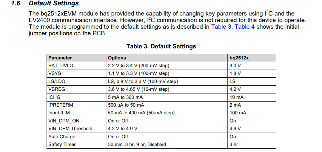

Hello
     I am testing power supply section (BQ25121A) and I am facing an issue to get Default battery charging voltage 4.2V in BAT pin. I am applying 5V at VIN using USB, I have connected ISET, ILIM and IPRETERM External resistor with BQ25121A. I am getting 2.5V SW default output. But I didn't get battery Charging Voltage at BAT pin.
