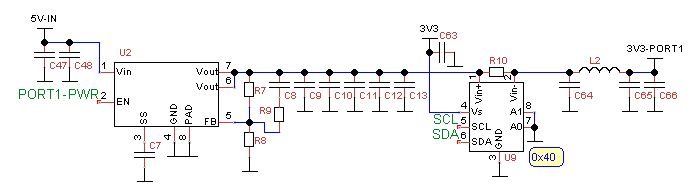

Hi - We're evaluating this part but we've had two failures where the input and output are both shorted to GND. Can you explain what could cause that to happen?
Vin = 5V, from a bench PSU
Vout = 3.3V
Iout = 2A resistive load.
The output waveform looks well-controlled. Blue is the enable input. Red is the output. 1mS/div, 1V/div
  • C47,49,9,10,11,66 = 47uF ceramic
    C12,64 = 1uf ceramic
    C13,65 = 100nF ceramic
    C7 = 2.7nF
    C8 = 82pF
    R7 = 100K
    R8 = 32K0
    R9 = 665R

    Many power supply failures are related to the PCB layout.  Can you post yours for review?
    Is there anything between the 5Vin and the external power supply?  Have you already checked for hot-plug overshoot of the 5Vin?
  • There is nothing between 5V-in and the bench supply. Would you recommend a MOV across the input of the LMZ10505?
    Can you explain the likely failure mechanism when a LMZ10505 input and output are shorted to GND?
    I have attached some waveforms and the PCB layout for review. I notice that for some reason, the GND plane for the EP of the LMZ10505 does not extend to the input and output caps We will certainly fix that in the next PCB spin. Could that potentially be the problem?

    Yes, both the Cin and Cout should connect directly, on the top copper layer, to the exposed pad of the device.  Vias in this path add inductance and are not recommended.  For a quick test, you could scrape away some soldermask to create places to solder the caps, where shown in figure 30 in the D/S.
    When Vin and Vout and GND are all shorted like that, it is most likely EOS on one/both power FETs inside the device.  This is usually the result of a too-high voltage occurring on the IC pins--either from excessive ringing during switching or Vin hot-plug.

     Do you get the same Vin waveform when you turn on the external power supply and then plug it in, compared to plugging in the power supply and then turning it on?
