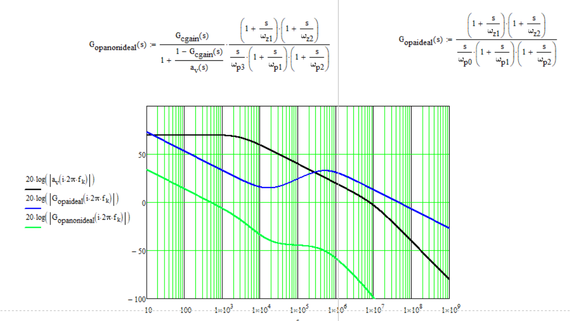

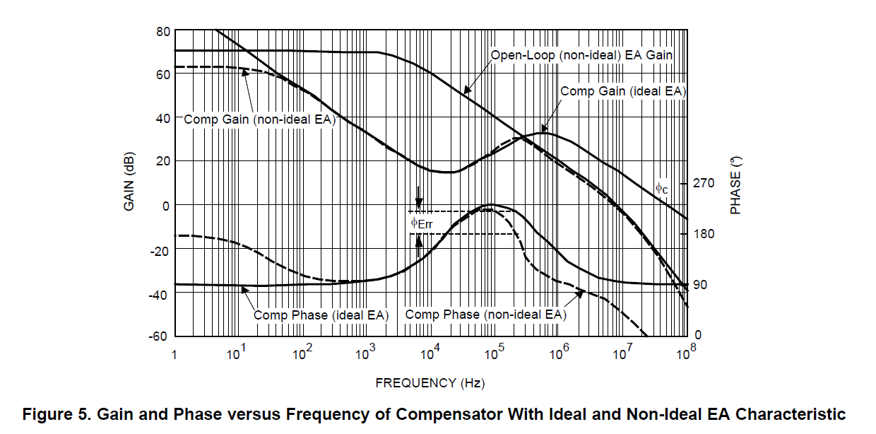

I read the TI paper about AN-1997 Error Amplifier Limitations in High Performance Regulator Applications, and I have some questions
1.)in this figure I don't understand why the DC gain (Low frequency) can't match the ideal compensator, in the high frequency why the compensator would follow the open-lop EA Gain
2.) If I want to use marhcad to simulate the type III compensator (nonideal EA), is my formula wrong? the green line can not match the figure 5.
