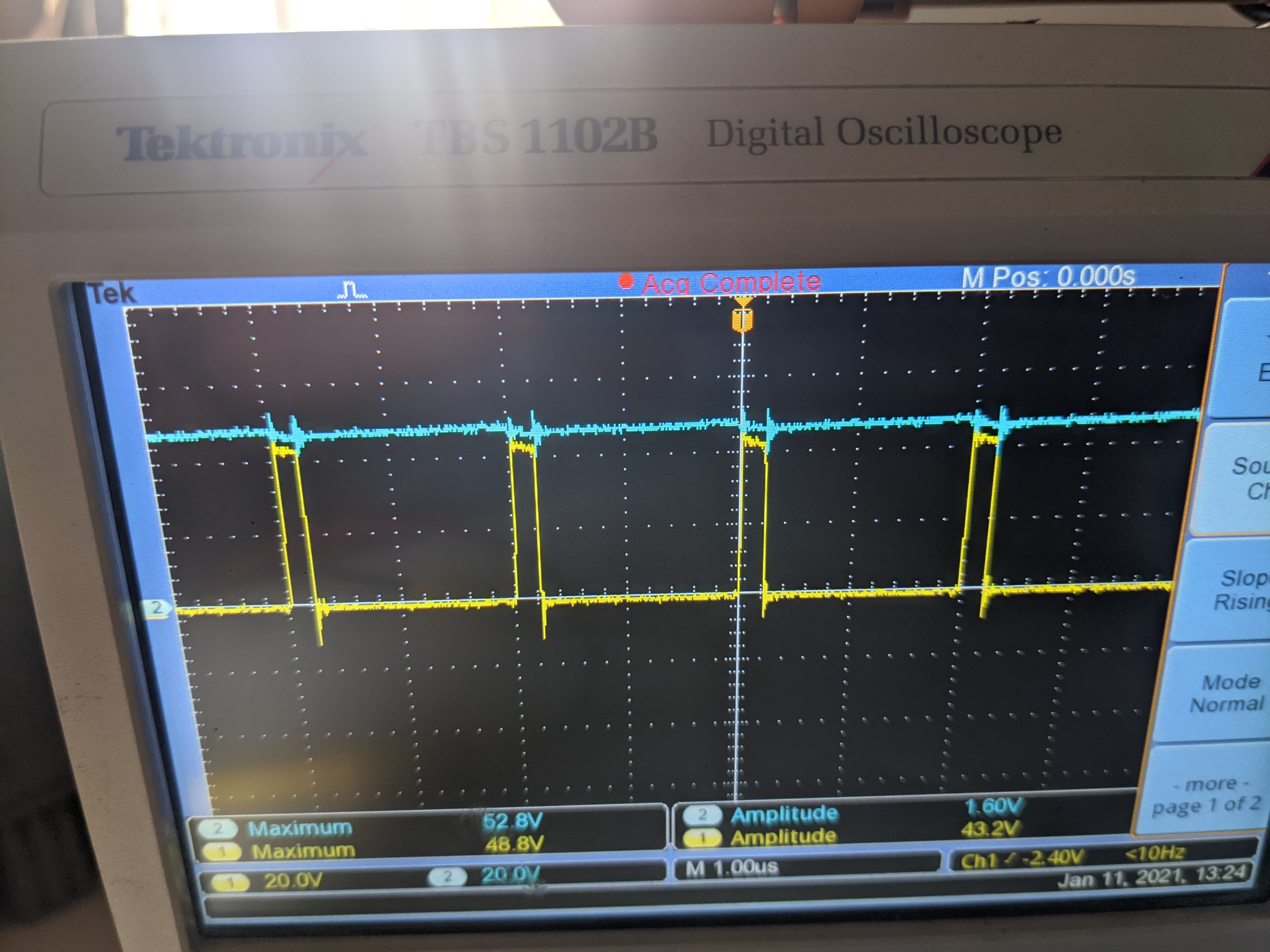

    I have attached the schematic PDF if that does not work out please let me know and I will send you the individual pictures of the schematic. I am not using the NTC which is mentioned in the design as that gives a weird behavior with the motor and I can discuss that after this issue is resolved.
    Also attaching the waveform for the VIN, Vout, and SW in a normal and operational state.

    Please confirm the operating conditions related is the last scope waveform plot.
    Tim

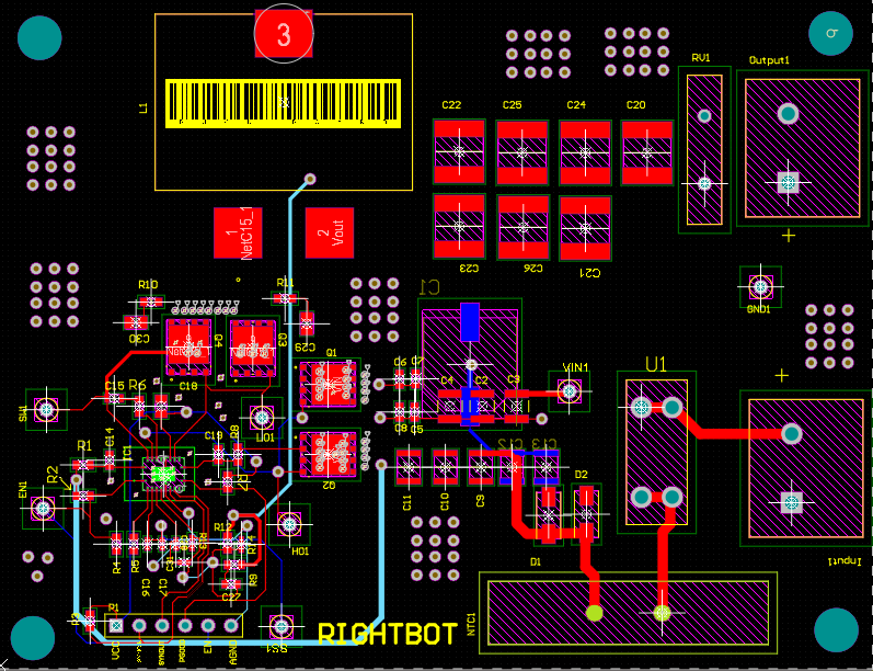

    I am attaching the layout for my design and the input caps can be seen as close to the High side fets, I have followed the app notes and the evaluation board guidlines.
    As my switching frequency is 250Khz my current is 28mA which is in the range which you have mentioned. Also,I was thinking of putting a fuse and an Over voltage protection circuit on the output for extra protection of my system.
    Thanks a lot for your suggestion I will double-check my calculation for a single MOSFET.

  • Hi Naman,
    Here are some comments:
    1. Inductor power dissipation in the quickstart file is 16W at 24A - need a lower DCR.
    2. high-side MOSFET loss is also way to high. Each 5 x 6mm package can generally dissipate 1W. Use 60V or 80V devices (100V parts are too inefficienct at this high current).
    3. Where are the input caps located? See app note snva803 for correct placement.
    4. Refer to the layout guidelines in the LM5146-Q1 datasheet. For example, the gate drive traces should be 20mils wide. Use copper to remove heat from the IC DAP (54V x 28mA = 1.5W).
    5. Check the loop crossover frequency. General guidelines is 10% of Fsw, 15% max, so 30-40kHz is a good target for a 250kHz design.
    Tim
