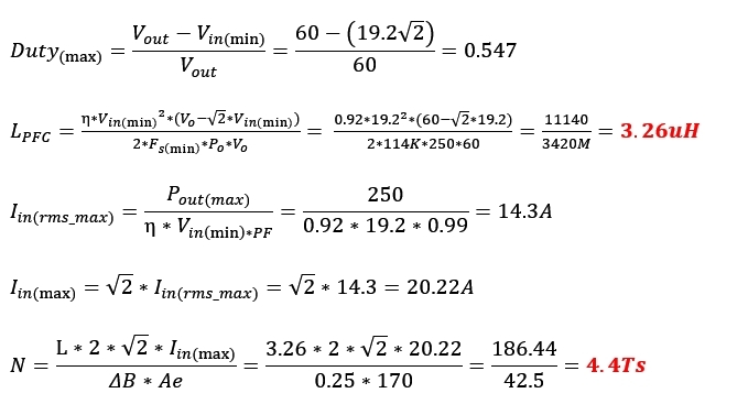

May I have your suggestion for customer design for 250W active clamp design?
Thanks.
Design spec.
AC19.2V ~ 31.2V ( Vnom = AC24V )
PFC boost to 60V
DC Output 12V/21A
PFC Transformer : PQ3220 / 3.3uH / 4Ts
Forward Transformer
  1. Isolation transformer :
PQ3220 /  Np : Ns : Naux = 4Ts : 2Ts : 2Ts / Lp : 13.5uH
Na (匝數比) : 2
  1. Secondary side energy storage inductor :
- N1^2*AL = N1^2 * 7310n = 13.33uH = N = 3.3Ts  use 4Ts
PQ3220 ( AL = 7310 )  / 13.33uH / 20Ts
  1. Please help to check if all 3  spec. of PQ3320 (corePC40) is OK or not?
  2. CS (how to calculate CT/ how to calculate Aux inductor?
  1. Is there any problems/suggestions for the schematics?
ThThanks.
7752.UCC2897A_SLUC662_12V_21A.xlsx
Boost PFC Design 20210105.xls
AC19.2V_31.2V PFC for 250W.pdf
BT_forwad DC12V_21A for 250W.pdf
