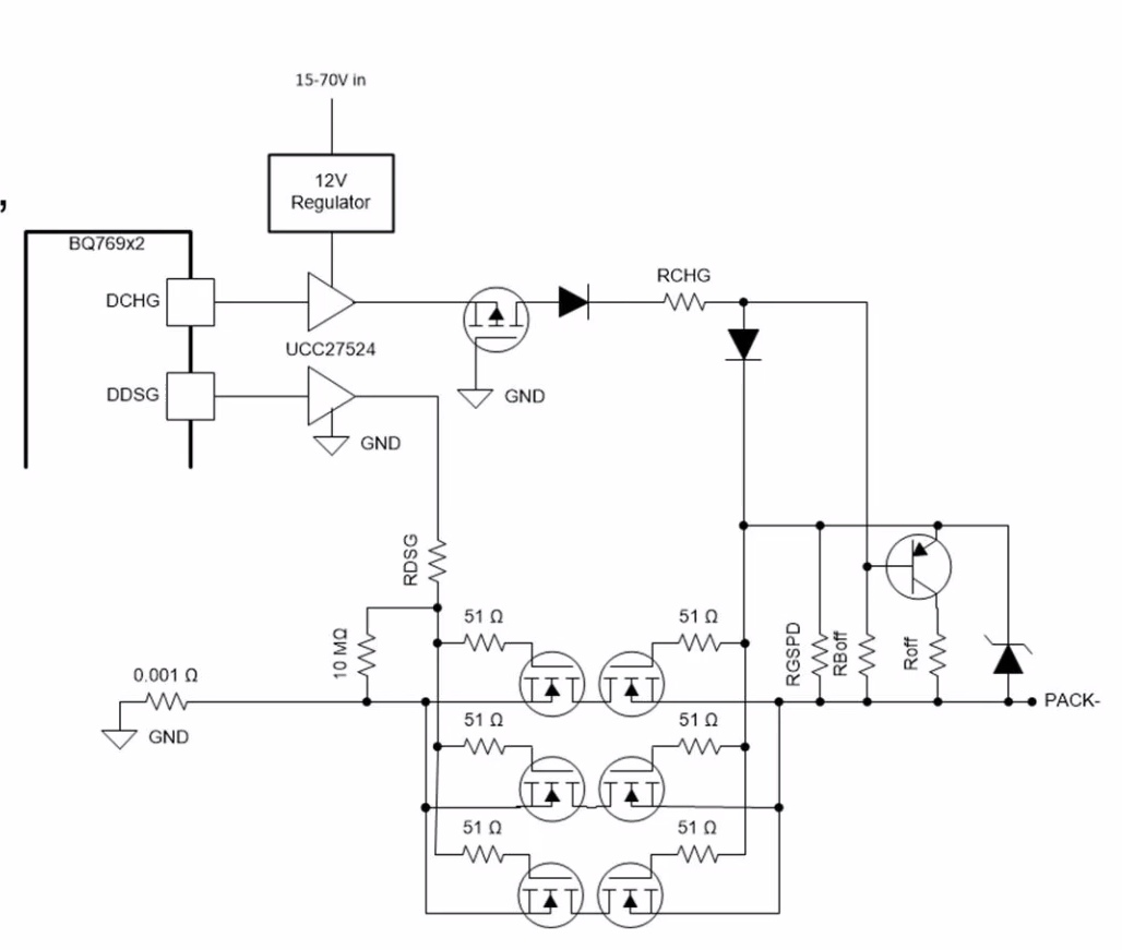

Hello
Suggest a way to implement Low side FET's using DDSH & DCHG in BQ76952.

Please check the training video (4:35) on BQ76942 / BQ76952 battery monitors: FET configurations and cell balancing (here).
Hi Anjan,
That is a good idea, but it does not exist today.
For configuration on the BQ76952 see the technical reference manual https://www.ti.com/lit/pdf/sluuby2
For information on regulators see http://www.ti.com/ldos or http://www.ti.com/dcdc, for a linear regulator which may fit the box description above https://www.ti.com/product/TPS7A4001
For gate driver options see http://www.ti.com/gatedrivers, for the part shown http://www.ti.com/product/UCC27524
