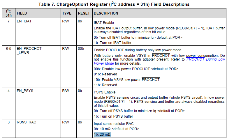

I have changed the input current sense resistor from 10 mohm to 20 mohm to increase the resolution of input current reading from 50mA to 25 mA (ADCIINCMPIN() (2B/2Ah) register).
What other changes I have to do for other registers related to input current (IIN_HOST(0F/0Eh) and IIN_DPM(25/24h)) ? Do I also have to halve their LSB?

  • Dear Linhong, please read section 9.6.6.1 of datasheet of BQ25713 (provided below) that says that 20mohm input sense resistor can be used for higher regulation accuracy, which is my case since I'm treying to find the Maximum Power Point of a PV solar panel based on the input current and BUS voltage information.
    Also please read the ChargeOption1 register which has a configuration bit RSNS_RAC which supports 20mohm configuration. However I'm not sure what is the purpose of this configuration bit?
  • Hi Di,
    Sorry about the confusion. You are correct! BQ25713B supports 20 mohm sensing. Yes, you need to set Register bit RSNS_RAC=1, and half all your calculations when you set up current settings(you don't have to change voltage settings).

  • Dear Linhong,
    To sum up, for an input current sense resistor (RAC) of 20 mohm:
    1. The LSB of IIN_DPM(25/24h) is 25mA? What about register ofset (value for 0x00), is it 50mA or 25mA?
    2. The LSB of IIN_HOST(0F/0Eh) is 25mA? What about register ofset (value for 0x00), is it 50mA or 25mA?

  • Hi Dmitriy,
    All current values will be half'ed.
