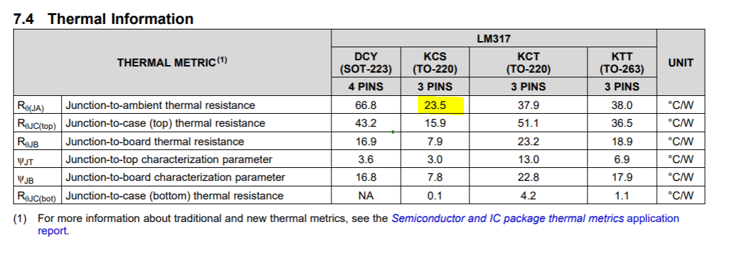

Dear TI expert,
    The datasheet of LM317 says it can output a voltage in the range of 1.25 and 37V. It also says it can output a current with the amplitude no less than 1.5A. So is the case with LM337.
    I wonder what is the maximum power LM317 can provide? Does the datasheet mean LM317, for example, can operate continuously with 22V output voltage together and 1.5A output current? I use LM317 in TO220-3 footprint, I have doubt whether it can handle such a large power.
Yatao
