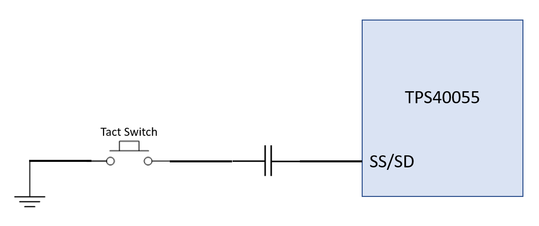

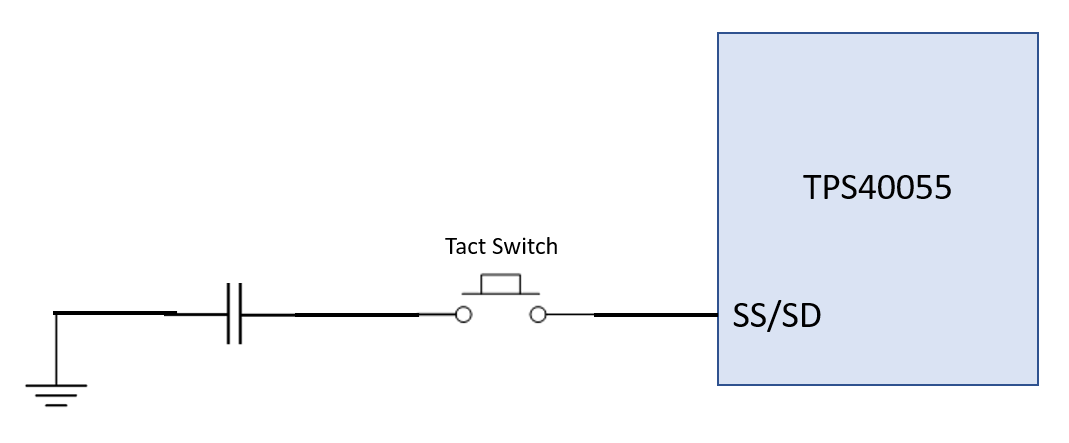

My customer wants to design with TPS40055, and they want to enable/disable IC using SS/SD pin.
please check the schemes below, which is right or not.
schematic 1 ;
schematic 2 ;
the difference is only the position of tact switch and capacitor.
and we just want to enable the IC when pushing the switch, and disable when release the switch.
please check this simple schematic, and let me know if there are some modifications or better ideas. Thanks.

  • Hi Chase,
    the switch should be parallel with the capacitor from SS/SD pin to ground.
    the switch should lock the ON state when push it, this will disable the chip.

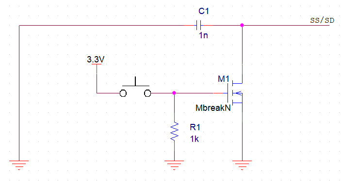

    then if I push the tact switch it will bypass the capacitor and directly connected to GND. right?
    and I have one more question, can I use FET for opposite result? I want to disable the device when I release the tact switch.
    so it should be connected directly to GND when I release the button.
    if I use N-ch FET, I can connect drain and source pin when gate is 0. so the result is opposite.
    but i am now sure about it because drain will connected to SS/SD pin, not power source.
    please check my thinking again. Thanks.

  • Hi Chase,
    You want to disable the device when you release the tact switch (the switch is off state), right?
    the you need to exchange  the position of  R1 and Tact switch !
