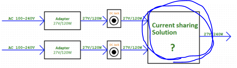

Dear Team,
Do we have any solution for this application without remote sense as below?
Many Thanks
Jimmy
UCC39002 series are load sharing controller that must sampling each module's load current. and the two controllers needs current shareing signal connection.
hope this helps you.
Hi Jimmy,
if only VCC and GND is in the system, there is no analog current sharing IC can be used.
