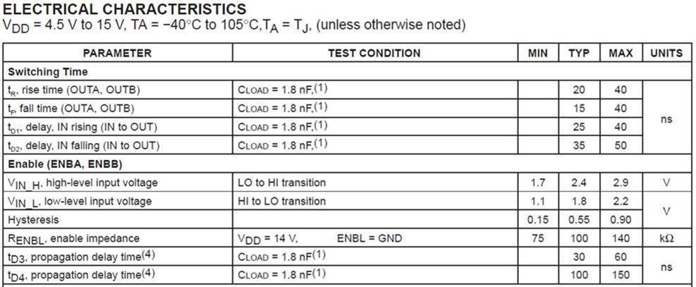

Hi Support team
following is electrical characteristics from D/S
regarding to rise/fall time
what is meaning of figure 13 and figure 14
the spec value is 20/15 ns typ
why the Y-rail of figure 13 and figure 14 is mS level?

Hello Red,
That is a typo on our end, the Y-axis should be in ns according to the 20ns specification.
I will send you an email where we can follow up if you have additional questions.
