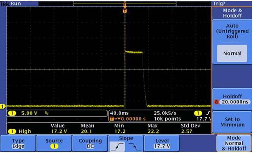

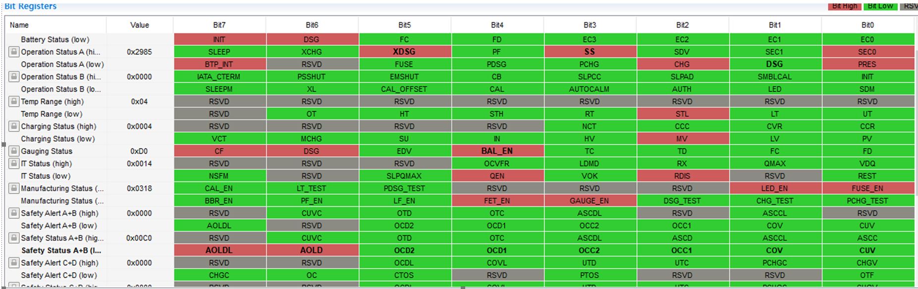

Short test was conducted on a board with BQ40Z80.
At this time, if you use BQSTUDIO, ASCD(Short Circuit in Discharge) has no response and AOLD(Overload in Discharge) operates.
The phenomenon of MOSFET turning ON/OFF is repeated when AOLD is operated. (ON about 300 ms)
1. Why is AOLD working when it's a short?
2. Is there a way not to turn MOSFET ON/OFF even if it is operated by AOLD?

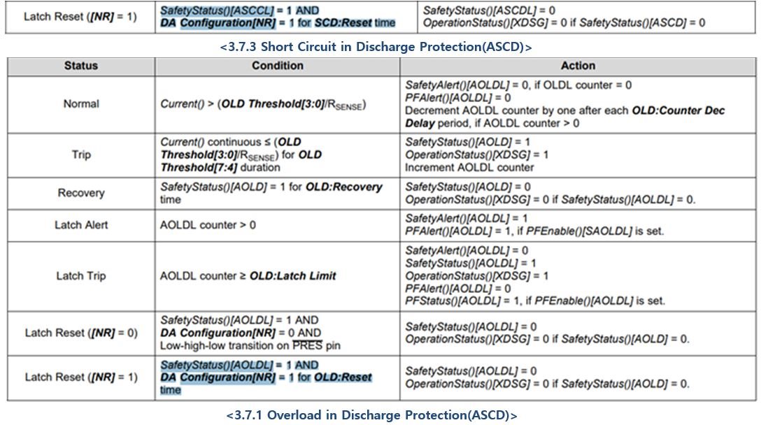

    I have 2 kinds of boards.
    One is NR=0 and other is NR=1.
    NR=0 is not a problem if you do it the way you told me.
    However, products with NR=1 are equaly ON/OFF of MOSFET phenomenon.
    I think the reason is because LATCH settings are different like below.
    Can you prevent automatic reset even if it's NR=1 of ASCD,AOLD?
    If you know, let me know how.

  • Hello David,
    Correct, it will get reset after the reset time for each of those protections when the NR = 1.
    Sincerely,
    Wyatt Keller
