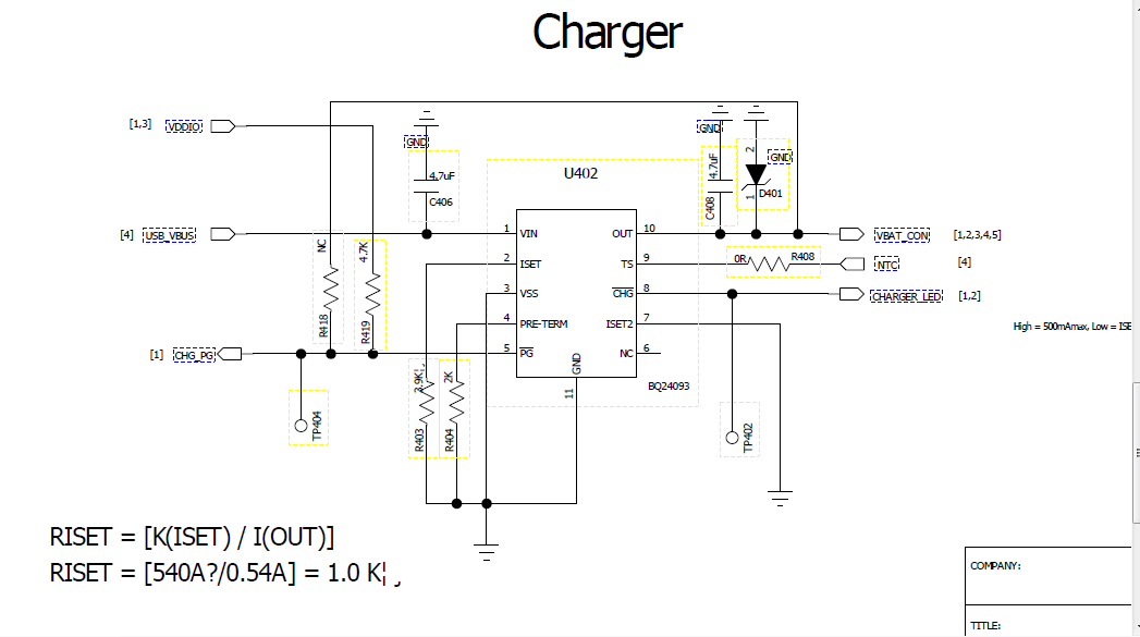

BQ24093: About the charging current setting problem
Part Number: BQ24093
The previous design I set the current resistor R403 set to 6.04K, the theoretical charging current is 540/6.04 = 89mA, and the actual test out the same value.
But currently I want to get about 140mA charging current, I set R403 to 3.9K, theoretical charging current is 540/3.9 = 138mA, but the actual test out charging current is still 90mA.
I tested two pieces of mainboard results are like this, why the charging current will not change?
Can you help me to confirm the problem? Thanks
