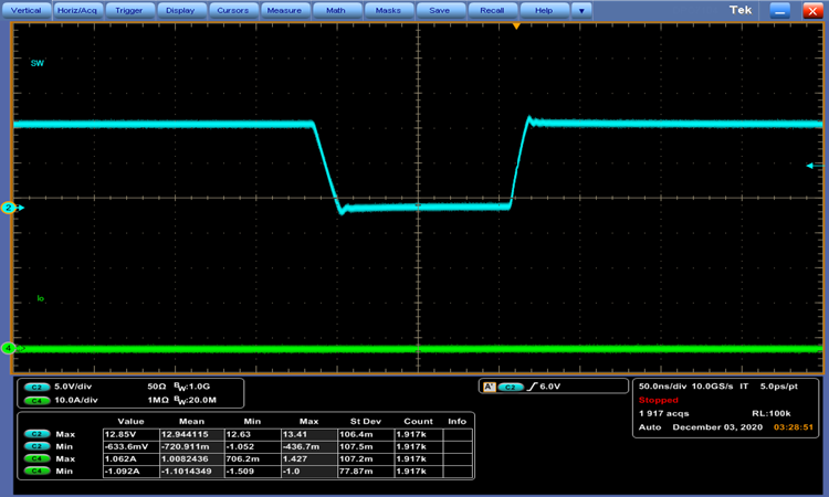

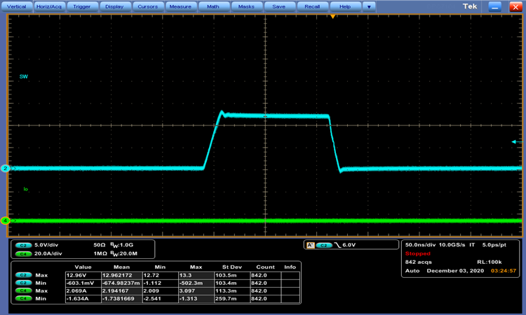

Hi team,
Customer found that LS Vds (Vsw) of TPS548D22 seem to have a long rise and fall time under light load. So they have concern about the short through risk.
I got three questions:
1. Is the tr or tf normal?
2. Is there any short through risk in this case?
3. How long is the deadtime? I haven't see in the datasheet.
Thanks!
